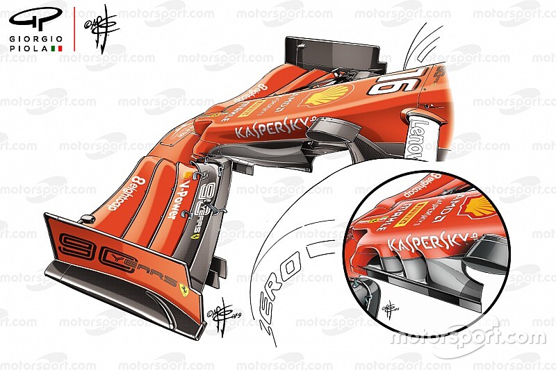

Ferrari SF90 front wing
Photo by: Giorgio Piola
Already the cream of the crop in a straightline, the Scuderia were looking to devastate rivals at the ‘Temple of Speed’ and ran with an extremely skinny upper flap configuration at Monza.
Ferrari SF90, front wing comparison
In a bid to resolve its higher downforce woes, the Scuderia installed a new nose solution for the Singapore GP, which incorporated the under-nose cape solution used widely up and down the grid. This side-by-side comparison gives us a clearer understanding of how it achieved its installation with the cape integrated into the front wing pillars.
