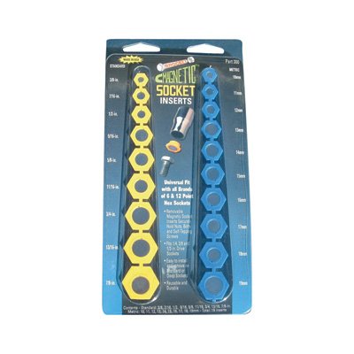

    FBB/Pete...question...What's the method for starting the nuts onto the threaded studs for the intake manifold? Dropping one of those under the intake could ruin your day... :)
  16. fatbillybob

  17. moorfan
    moorfan Formula Junior
    Joined:
    May 11, 2009
    Messages:
    809
    Location:
    Central Virginia
    Pete
    THIS!
    You don't even necessarily need the swivel drive extension, I use a long 1/4 inch drive extension with the special tip that allows the socket to "wobble" a little on the end (aptly called a Wobble extension).
    And don't worry about dropping one of them down into the valley under the plenum. That is what a telescoping magnet is for!
    Pete
  18. dersark_painclinic
    dersark_painclinic Formula Junior
    Joined:
    Mar 8, 2005
    Messages:
    981
    Location:
    Glendale, CA
    Lazik Der Sarkissian
    This is what I use.
    http://ecx.images-amazon.com/images/I/41OA2xPmvyL.jpg
