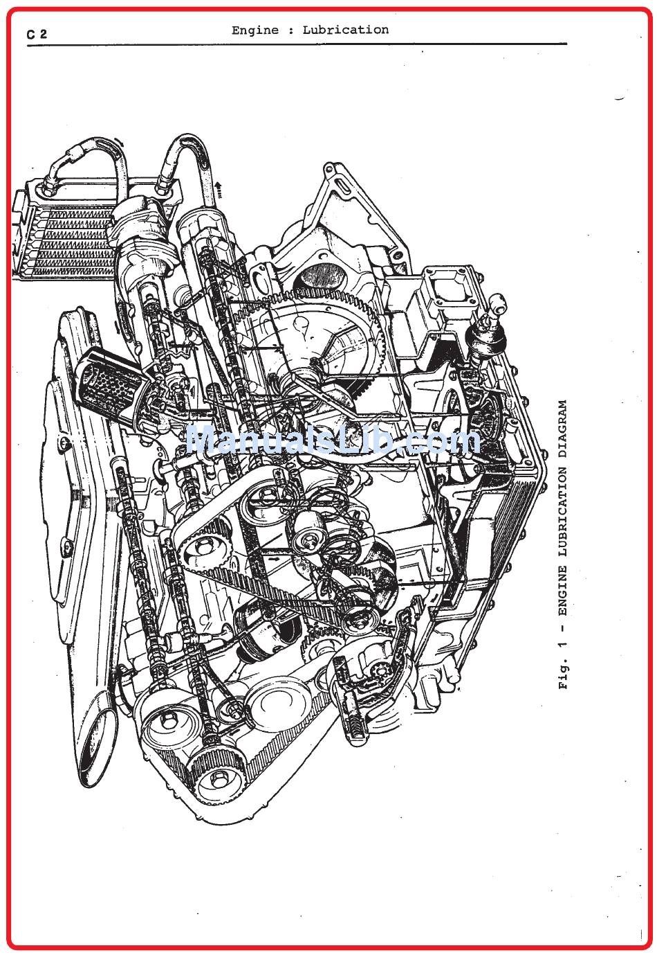

    I’m not sure myself if flow would be reduced, I still had good oil pressure and coolant temps. My thoughts are once the valve cover was filled with oil, it just went it’s normal way. Does anyone have a drawing of the oil passageway?

    Oil at pressure is fed to both the mains and the cam journals. From there it gravity feeds back to the sump. The cylinder heads have no other return path then those 2 drain back holes. If they are blocked, the head will fill until pressure builds and pops a seal. Flow to the heads is not huge, those dowel pins control the rate. Would take some time to fill up. It would eventually happen though. 4k miles should have been suffecient though, I'd be looking at oil passage flow in the heads as well.
    The galled gudgeon pin is proof that oil starvation was occurring. It really would have gotten worse with time. I'd check the cam journals for scoring.
    Yrs ago we got an engine in that a previous shop had the cylinder heads glass beaded to clean up... Yeah bad idea... Passages gummed up with fine glass abrasion material. That was not fun fixing.

    Not really no, they are pressure feed ports to the cam journal, very tight tolerance. Really wouldn't want flow to revert thru those as it would mean a "dry" start on the cam journals after every shutdown.

    Doh... There is a return path to the sump for the 1-4 Bank.. port between cams feeds to the mid plate (later qv it's the exhaust cam end plate). It's a path, not ideal and will still leave the head filled with oil.
    If it was the 5-8 Bank... It would have built up till it pushed out the breather hose.

    Here's my take based on rebuilding more of these engines then I recall.
    The wrist pin is "splash" oiled. The engine block sits atop the gearbox. Now what's interesting here is the oil return layout. Bank 5-8 feeds right into the sump, Bank 1-4 drops onto a partial shelf before falling the rest of the way into the sump. That means that oil return from bank 1-4 will be closest to the crankshaft and windage tray. There's also the the oil return via the mid plate that feeds at the back of the crankshaft.
    Blocking the return to the oil sump on 1-4 would stop the majority of oil "splash" that occurs before returning to the sump.
    And there's the issue of reduced capacity since the head is filling up vs returning.
