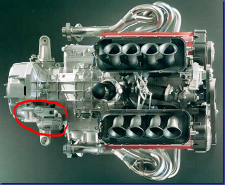

    Demetrius
    You don't need a lift or jack stands. The starter comes out from the top.
    http://lh4.ggpht.com/-bM4qqV_0vKM/UP6InBthtqI/AAAAAAAAHuc/Bl7Ax_d-4vw/image_thumb%25255B8%25255D.png?imgmax=800
    http://thumbs4.ebaystatic.com/d/l225/m/m5RAWStGVffYIgmx1uy1OLQ.jpg
    You can test if the key is turning the circuit on with a simple test light on the solenoid connection, the small wire, while someone turns the key.
