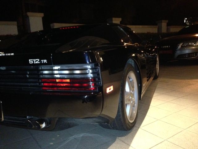

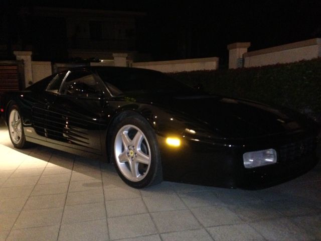

    after a LONG wait, i finally got my 512TR. many thanks to adams for letting go of it
    from everything i read in the past, i was expecting the worse and the drive to be like a truck. but i was so surprised. the car is very NICE and quite comfortable and easy to drive. the clutch is soft (for an exotic), the steering has nice weight and becomes very easy to turn with the car slightly rolling (no need of power steering IMO), the engine pulls nice and strong with a fantastic sound coming out of the flat 12 with tubi, and it rides well considering the bad roads we have in the philippines. i'm very pleased.
    i was expecting it would be worse than my '89 930. but on the contrary, it's so much easier to drive. honestly, it's like a modern day car, circa 2002 and above.
    my only issue now is the a/c is not functioning properly. prior to loading the car, the expansion valve was replace and freon recharged. my friend who had the car says the aircon was blowing very cold and no problems at all. 4 months later, it's all hot air.
