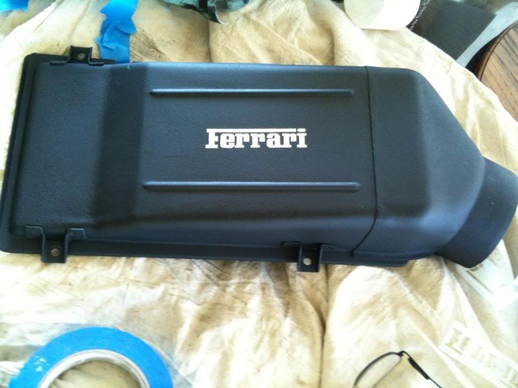

    An update to an old thread.
    Today I once again tried to get a decent "Ferrari" out of that Ebay stencil for my 328. I tried it SIX, count 'em, 6) times. I tried every method that has been discussed - painting black through the stencil first to "seal" the edges, using hairspray on the stencil to do the same, using spray adhesive on the stencil, etc etc etc.
    After five attempts, washing off the white with lacquer thinner and respraying the lid flat black each time, on the 6th attempt I finally ended up with what looks decent from a few feet away but is still nowhere near as sharp is it should be. If you are just looking at the engine bay it looks OK but if you are a Ferrari person you would know immediately that it's one of those ebay stencil attempts.
    Oh well, I guess it'll do for now...The pic looks better than the real thing! :)

    Yeah - I can't imagine getting that part to look decent with that stencil. At least on the '89 328 (US version, anyway), all that was originally on the air cleaner was "Ferrari." That was hard enough to get a decent looking job. By "decent," I mean that it looks OK from a few feet away as you generally look at the engine compartment.
