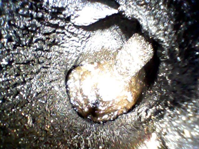

    F355 is correct. You do NOT want to use ANY solvent based upper induction cleaners on any DI engine due to the amount of intake valve coking. On an old port injection it would loosen and clean piston tops, but the large deposits on the DI intake valves breaks loose and damage the catalytic converters as well as the smaller hard particles are forced between the pistons and cylinder walls causing scouring. If yours is a turbo engine, then the impact of these larger chunks damages the leading edge of the hot side turbines as well.
    Only real safe way is a proper crushed walnut shell media cleaning with the valves closed on the cylinder your working on and all others taped off to prevent any debris falling into a port that has the valves open on.
    This is an issue with ALL DI engines, every automaker on the planet is battling this.
    Here are some videos and pics:
    https://www.youtube.com/watch?v=ONp6gQXpyKU
    Or using the stainless brush method:
    https://www.youtube.com/watch?v=7Pz0zTQ1bz0
    Here is why these deposits occur:
    Other techs are seeing these same things during tear-downs:
    Here is why this was never an issue on the older port injection engines as the fuel constantly showered the backside of the valves so deposits never had a chance to form:
    Most techs can remember back to the very old carbureted engines where we had coking deposit build up and valve guides rarely lasted more than 40-50k miles before needing an upper end rebuild. The past 25 or so years, we have rarely seen worn guides but now with DI where the fuel never touches the valves, we are seeing guides wore excessively at 20-30k miles again:
    Every cycle of the valve up into the guide draws up these deposits wearing them prematurely.
    This valve stuck open due to the deposits and the piston made contact bending it:
    And here is what intercoolers look like after 15-20k miles on those that the PCV vapors pass:
    Also, many notice rough idle and hesitation when transitioning from idle due to the disrupted airflow into each cylinder. The injectors are delivering equal fuel amounts with each cycle, but the air entering is varying causing unequal A/F ratio in the combustion process....when not to severe the engine smooths out at higher RPM's, but the more severe the coking, the more misfires occur.
    The only solution is to stop the oil and other contaminates from entering the intake air charge, and almost all of the so called "Catchcans" on the market allow most of this to pass right through doing little to solve the issue. Here is from another site where a long term (months and thousands of moles) test was done to show how ineffective most solutions are:
