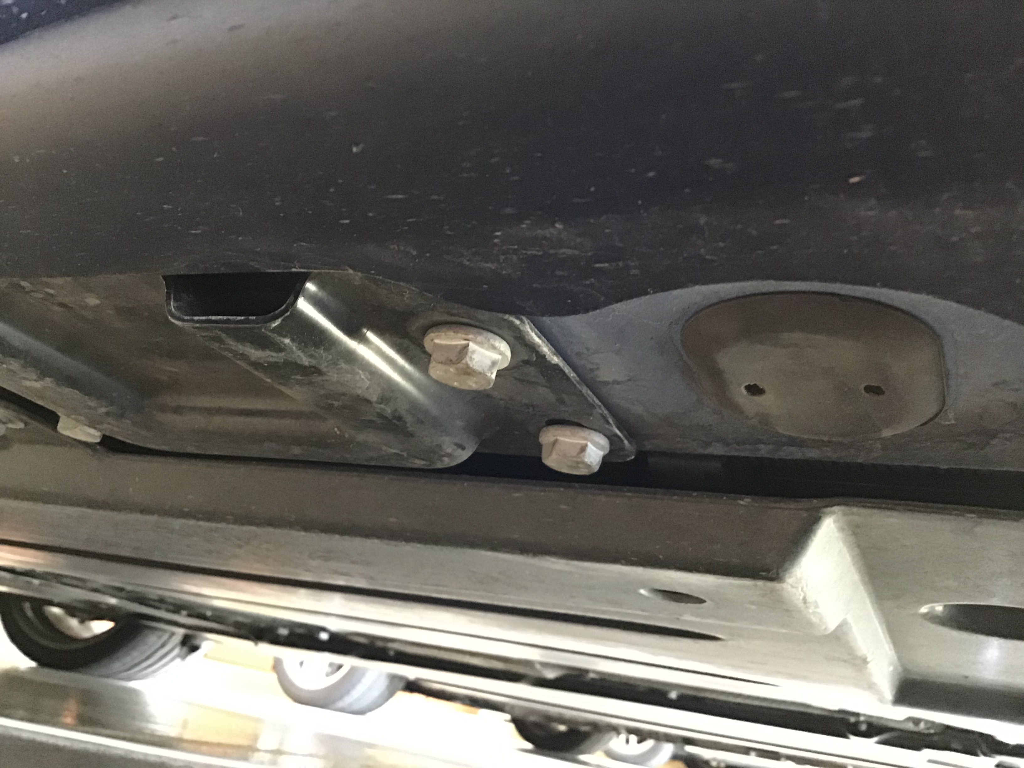

    Here you go. I've jacked up my car many times, a few times in a big hurry.
    FWIW, I use a hockey puck (I'm Canadian eh??) to interface my "racing jack" to the jack points because the rubber pad in the cup on my jack arm is way too thin for the cup to clear my car's underbody. My hockey puck provides a perfect fit on the round jack pad in the front (not the larger oval one) and also fits the single rear jack point perfectly.
    Do not attempt to jack up your car at any other locations unless you are very experienced and can safely locate non-factory-specified jack points.

    I also need to lift my FerrariCalifornia. Based on the photo ibelow, is the jacking point the metal plate or the oval rubber thingy? Just want to be sure. Also, what is the socket size for the california wheel nuts ?
