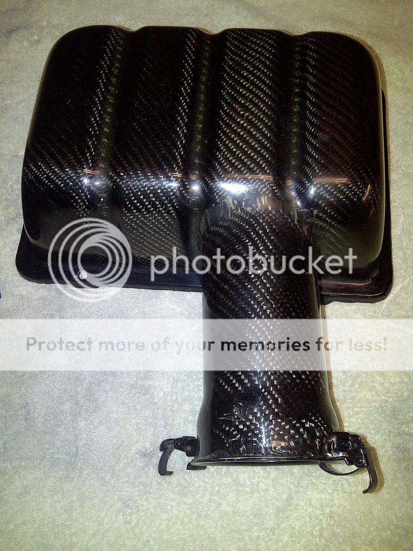

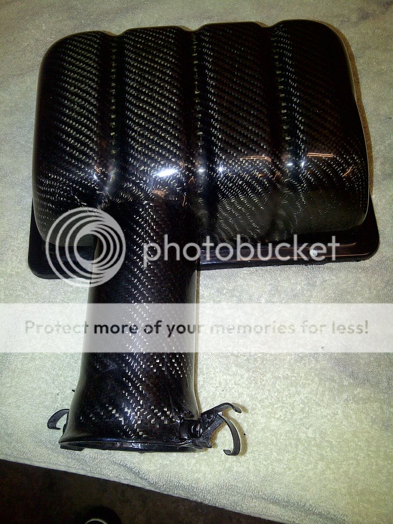

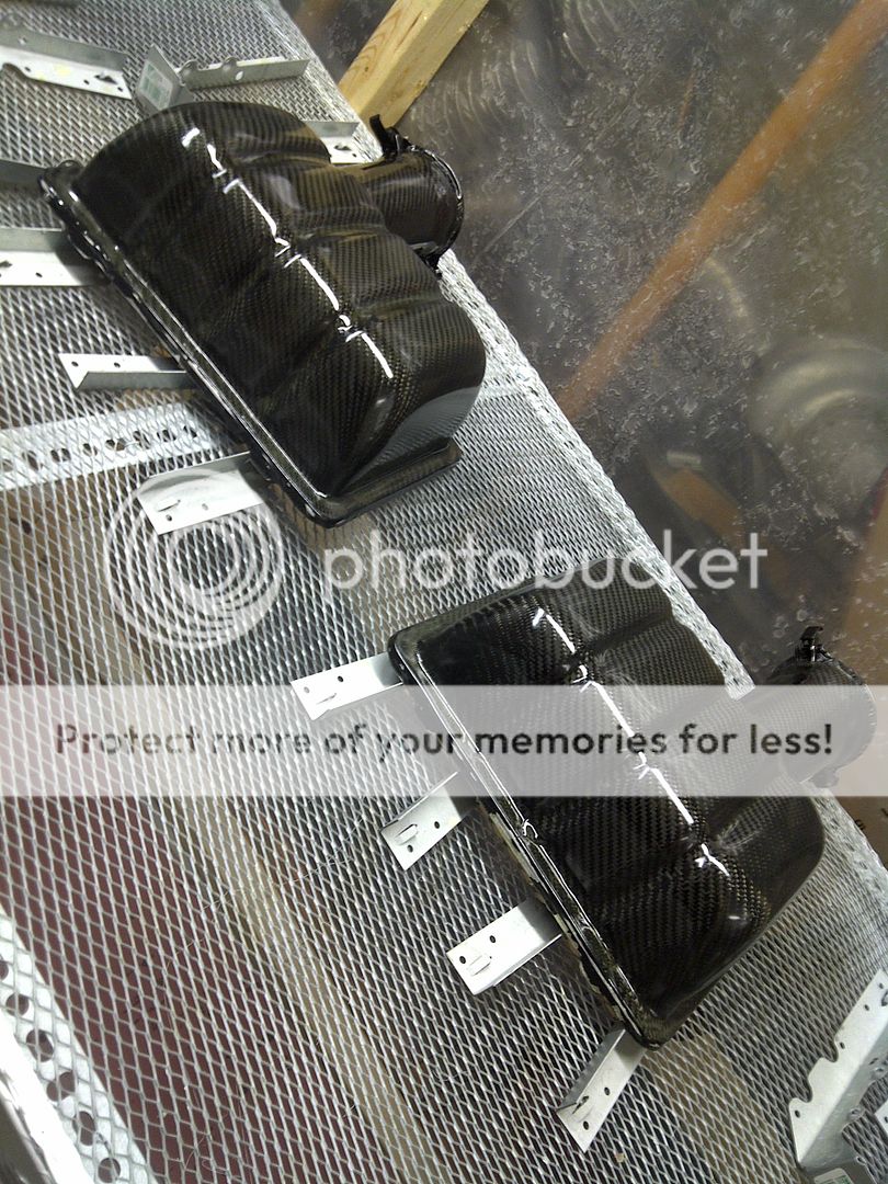

    Hey!

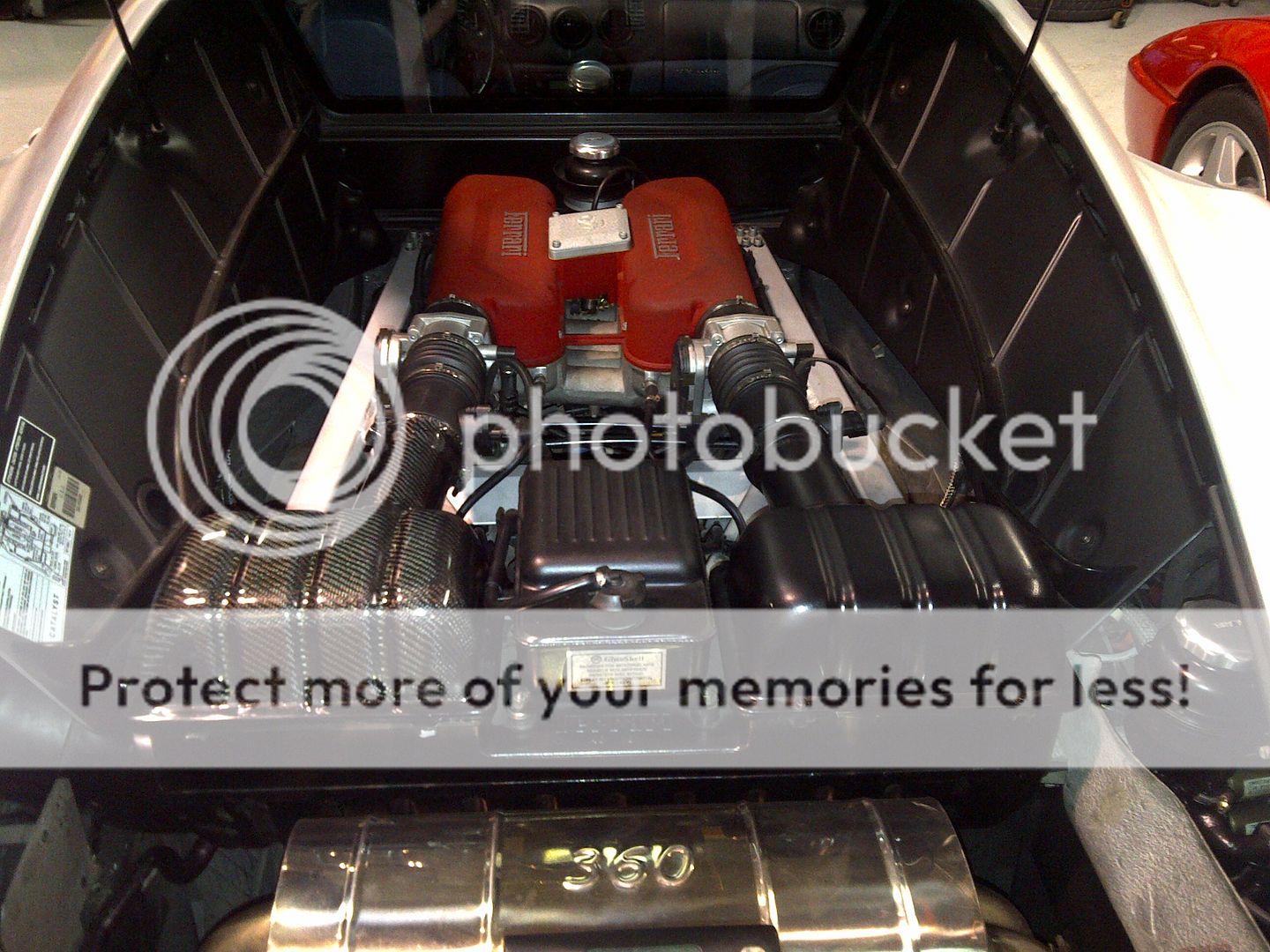

    Just test fitted the new intakes to my buddies 360. Parts are 90% done; final sand, paint and final clear coats and then done!
    Will take new pictures when parts are completely finished and post them...... Should be really nice when completed.

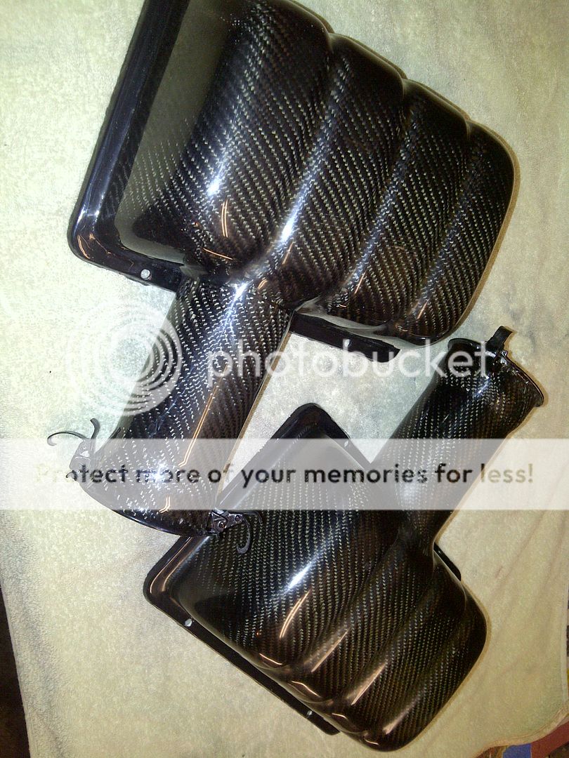

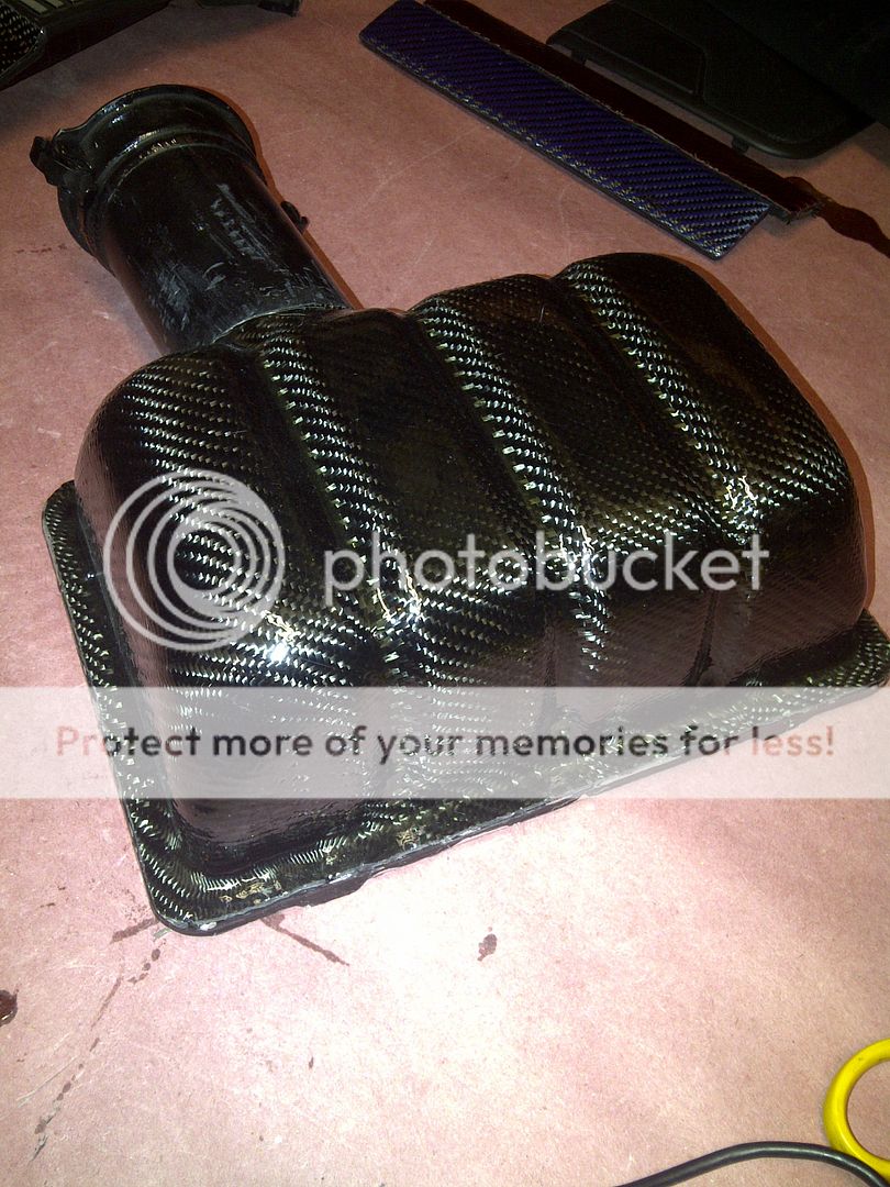

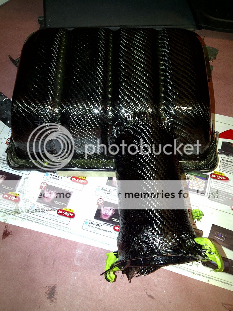

    Nope; the real stuff. Carbon fibre cloth embedded in resin and clear coated. Both the resin and clear coat were selected because they are chemically resistant, ultra high clarity, wide operating range and have built-in UV protection. Not a fan of the vinyl wrap myself!
    Here's a couple of the inprocess pictures:

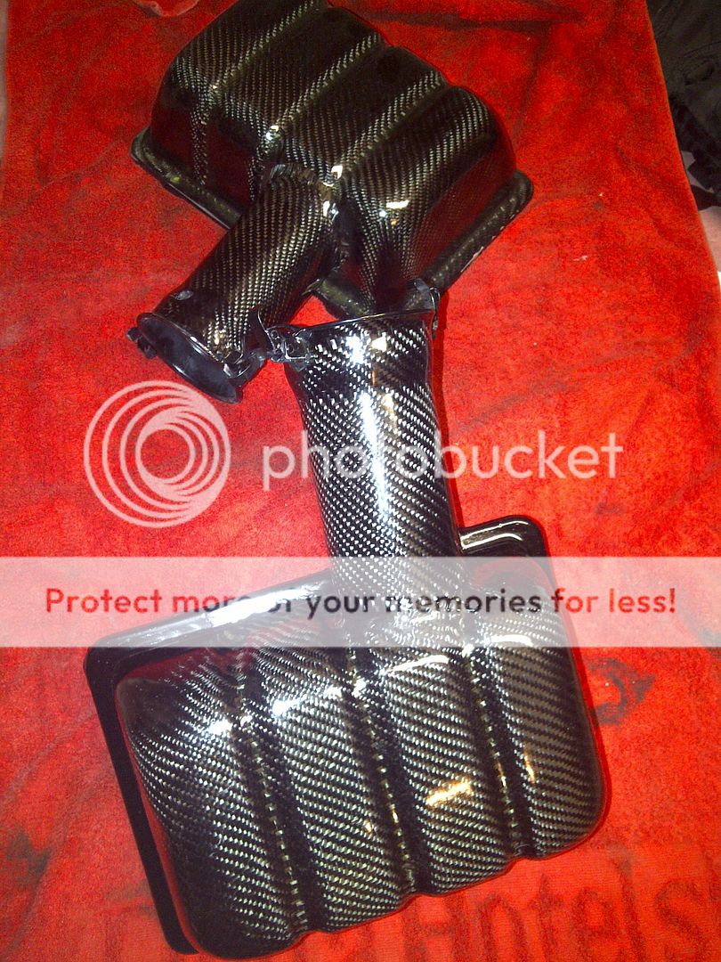

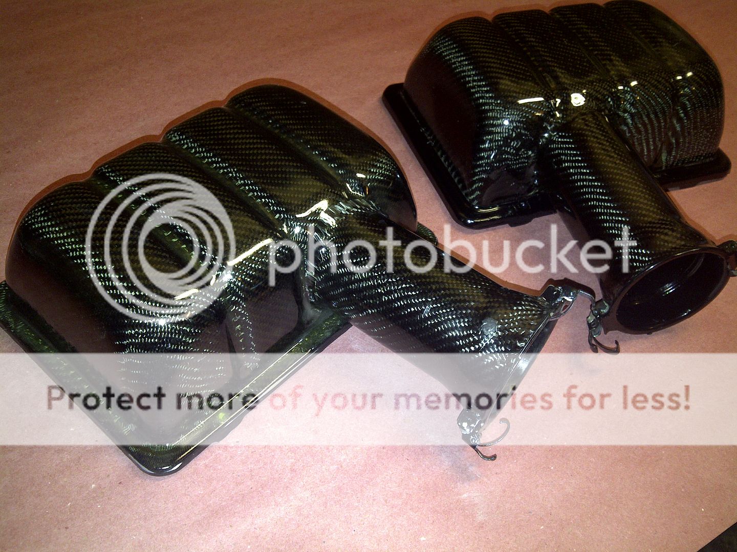

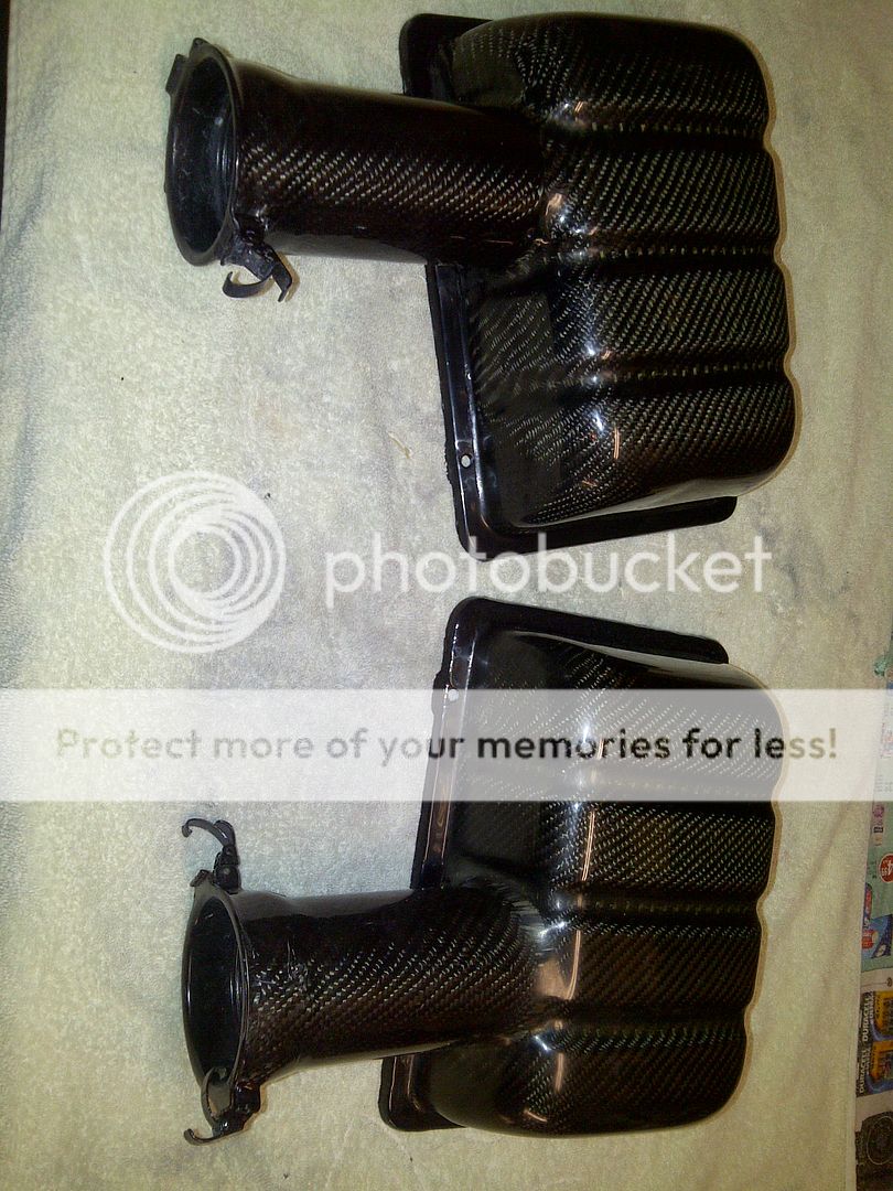

    Well. time for an update. Finished the intakes finslly. Project was put aside to complete other projects as the car was in storage. Well; as spring approaches, it became time to finish the parts.
    Well, here they are buffed, polished and ready for installation tomorrow...
    :thumbup:
