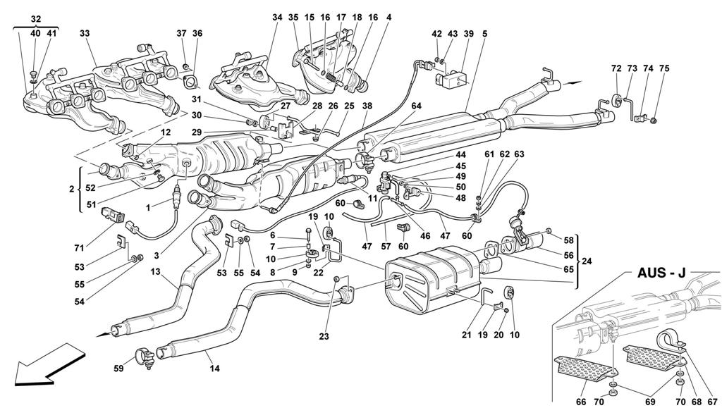

    Here's an illustration from the Ricambi website that shows the cats (Items 2 & 3):
    https://www.ricambiamerica.com/media/catalog/category/550_22.jpg
    If both blue plugs are unplugged, a previous owner has managed to bypass the cat ECU's, which is a very unwise thing to do on a car that still has cats.
    If the cats are indeed gone, then there's not much sense in keeping the cat ECU's but they have to be bypassed, not just unplugged. The bypassing could be that additional wiring that Daniel commented on.
