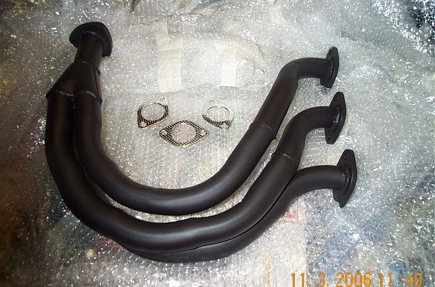

    Any one removed one lately ? I want to ceramic coat the headers , any easy way to remove them ? Do you remove the nuts by getting under the engine or from the top reaching down?

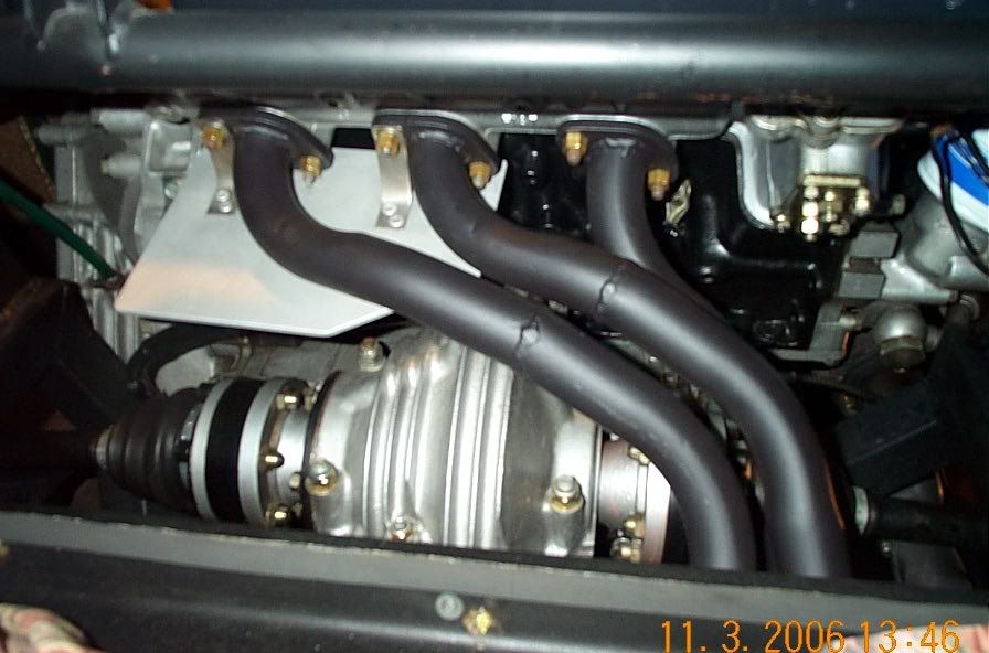

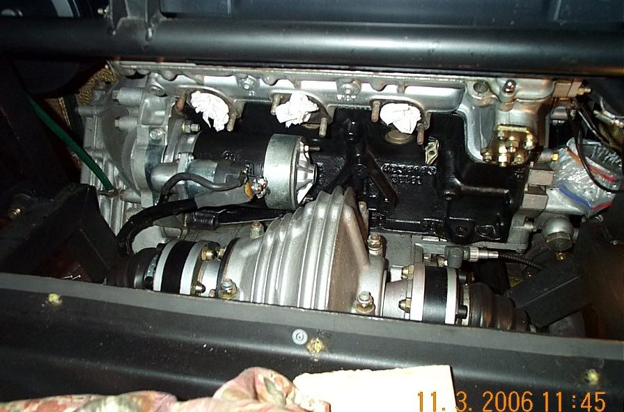

    Rear can be removed from left wheel opening. Just remove stone guard. Can remove from trunk also but only 6 nuts and you will probably want the left guard off anyway. Front is easiest by removing right gas tank. I know it is dangerous but it will save a lot of cursing and skinned knuckles. Just pump tanks dry, tip car to left to make sure right tank is empty. Remove hoses, plug opening to left tank with a rag. Remove right tank and there you are.
