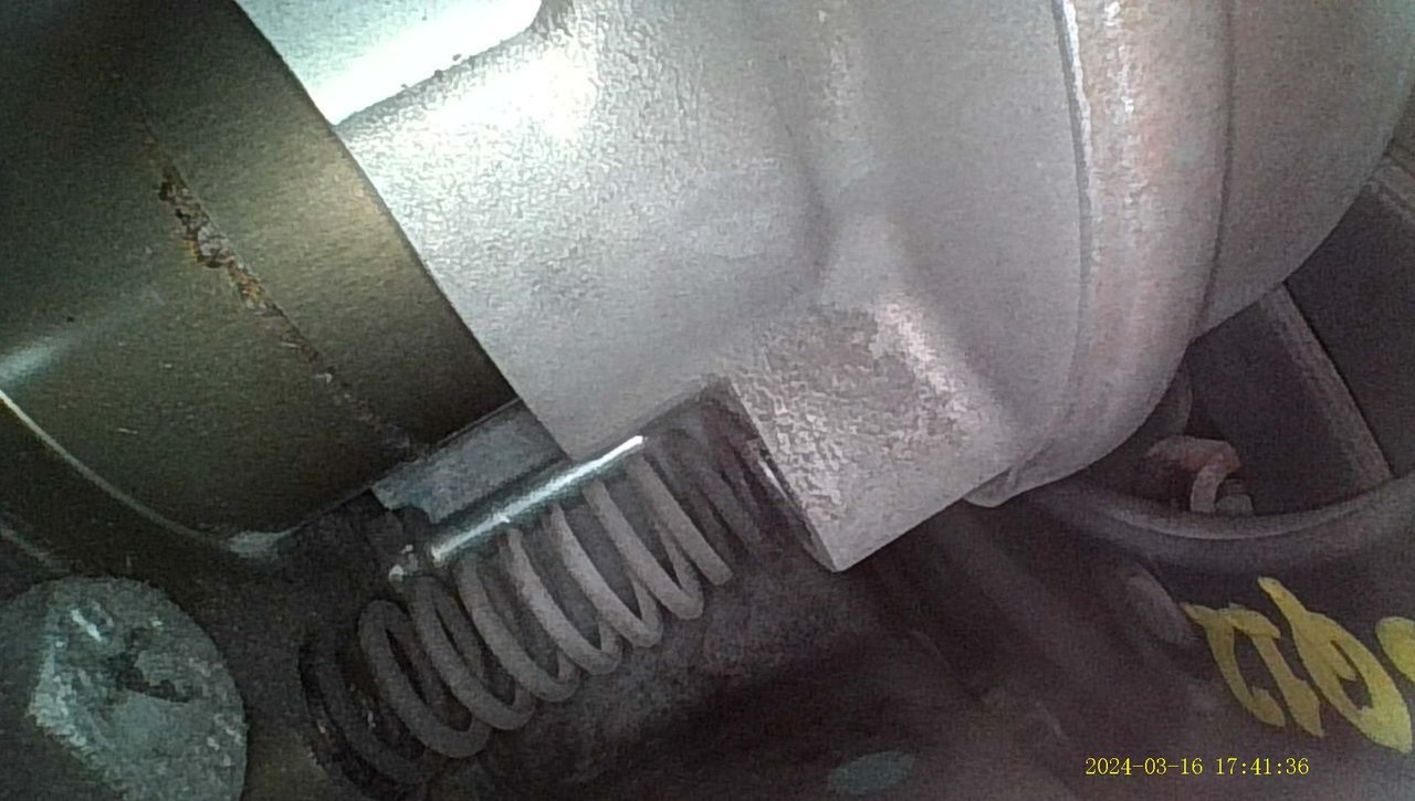

    We try to bleed the clutch (without opening the screw) to see the Clutch thrust bearing mouvement but the tool does not allow this function to be performed while displaying the computer values (position etc.).
    We try to re-learn: everything works but in the end no change.

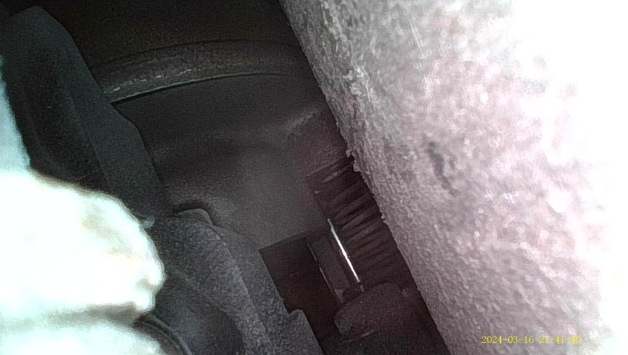

    Then we use a function in the OBD tool : activation of the clutch solenoid valve : it seems to work.
    The problem is that mechanically nothing is visible.

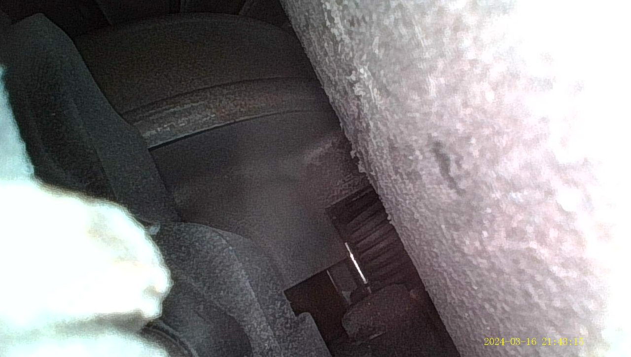

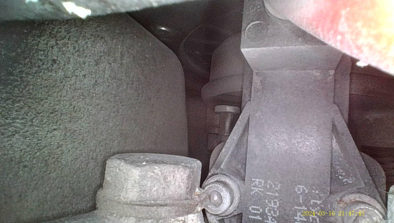

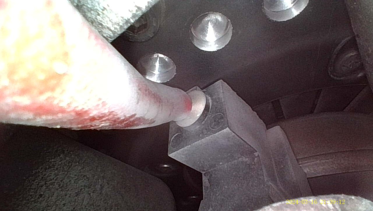

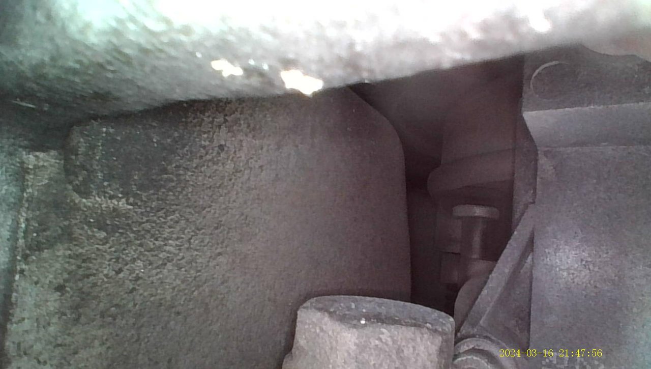

    We then try to introduce an articulated endoscope through the passage of the clutch sensor cable : it works, we see the Clutch thrust bearing live: I don't remember anymore, maybe it was necessary to start the engine then activate this function again : miraculously the Clutch thrust bearing moves on the screen.
    We turn everything off, turn the ignition back on : we are in N if we start (still PSR6 shunt) the clutch is open, the primary shaft no longer turns : progress.
    The Clutch thrust bearing moves as expected now.
    But we still don't shift into any gear (engine off or on).
    So mechanically everything is OK but the TCU decides that there is a problem and blocks the engine start using the start button but also the gear change !!!!

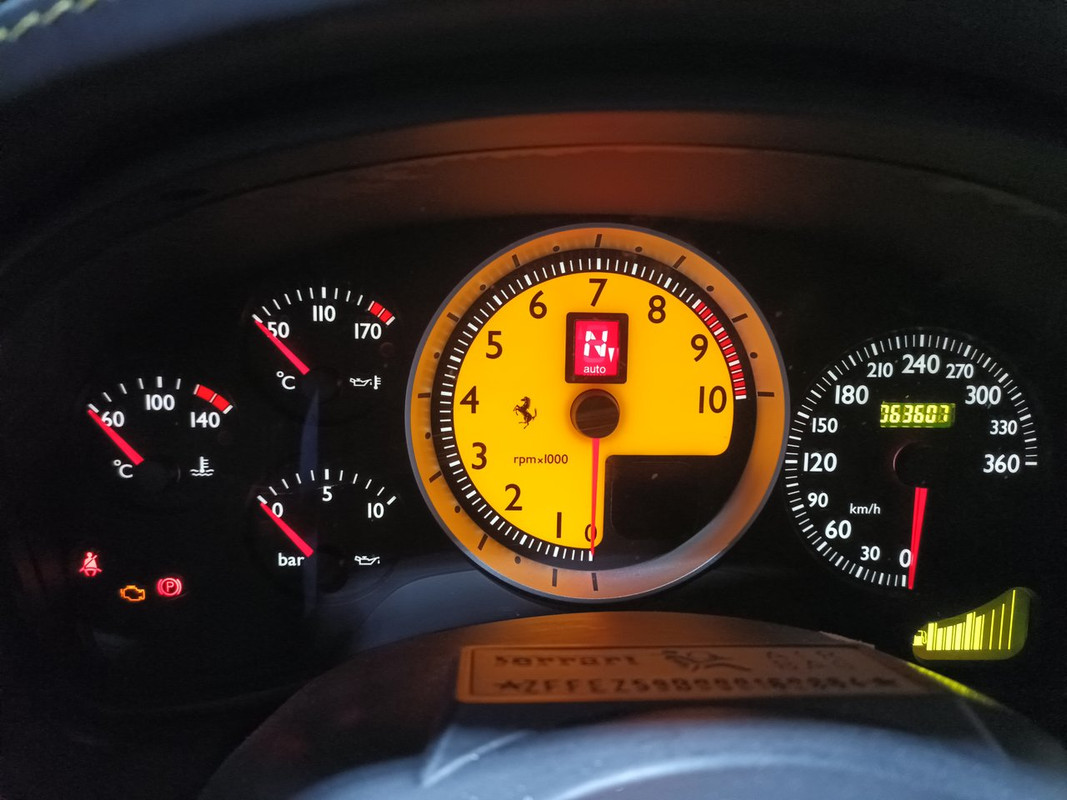

    We also notice at this moment that when the car starts, the gearbox is in N/Auto/Down arrow.
    You cannot remove auto mode or shift into reverse. You have to start the engine (still shunting PSR6) to remove auto mode (it wasn't like that before).

    What I think we proved today is that mechanically the F1 system is working .. clutch moves, solenoid is working , actuator is working and pressure is good ..we also proved that the TCU can send commands to open , close clutch and shift gears using diag tool ..
    The mystery is why does the TCU feel like in the US as if the brake pedal is not pressed ..same symptoms which we checked and the switch works
    I need to understand the conditions that the TCU needs other then hatch close, brake pressed etc to allow gear change or car start..i.must be missing something
    What I don't like is that the clutch position from.new was 0 ..that means to me that somehow the TCU got zapped and reset it .. unless the prior clutch job was done incorrectly..what else got zapped ?
    Also the magnet for clutch sensor is most likely put backwards....this shouldn't cause any starting issues from what I seen in other cars with same mistake

    By looking back to all the gathered data, I just find the error code 02B6 in the "Parking sensor" may this code be the bad guy ?
    Nevertheless, the car has a manual parking brake, in N we can move the car by hand.
    What I've found :
    So break pedal switch would be a an analog signal AND a CAN data.
  22. 308GTB1978
    308GTB1978 Karting
    Dec 21, 2013
    114
    France
    When looking deeply in my documentation, the symptoms looks like a "clutch position sensor recovery" strategy !
    No idea to get out from this ...
