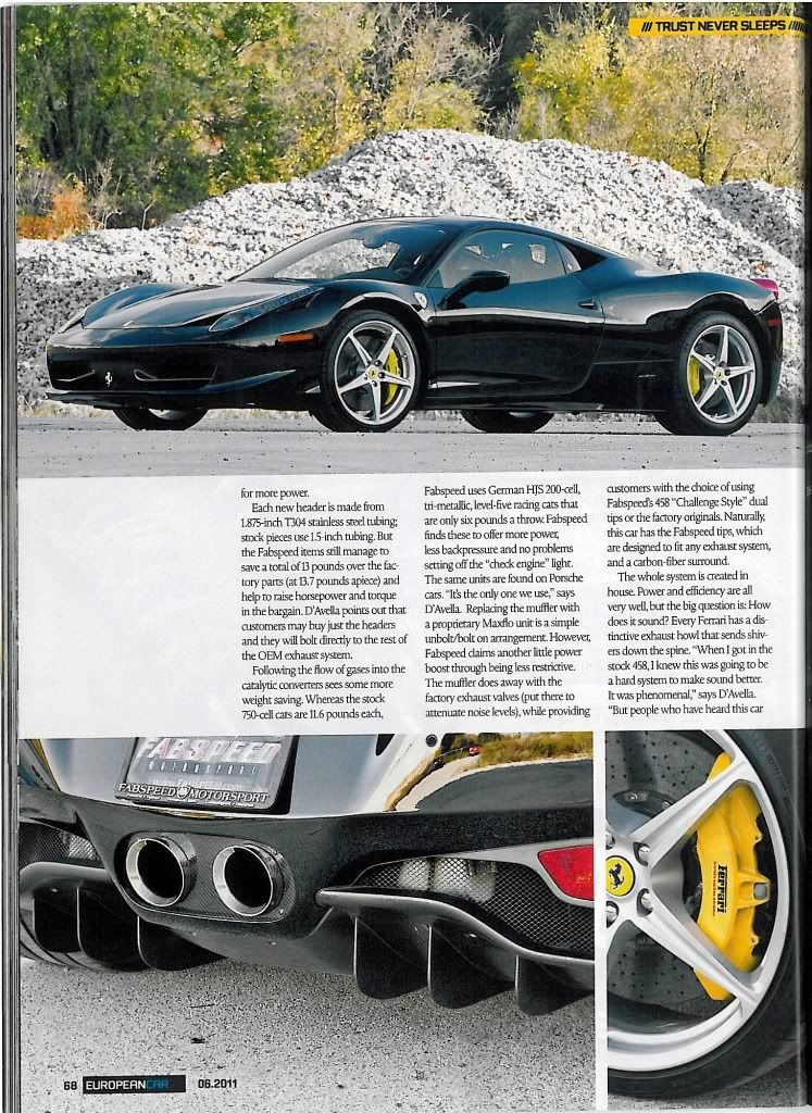

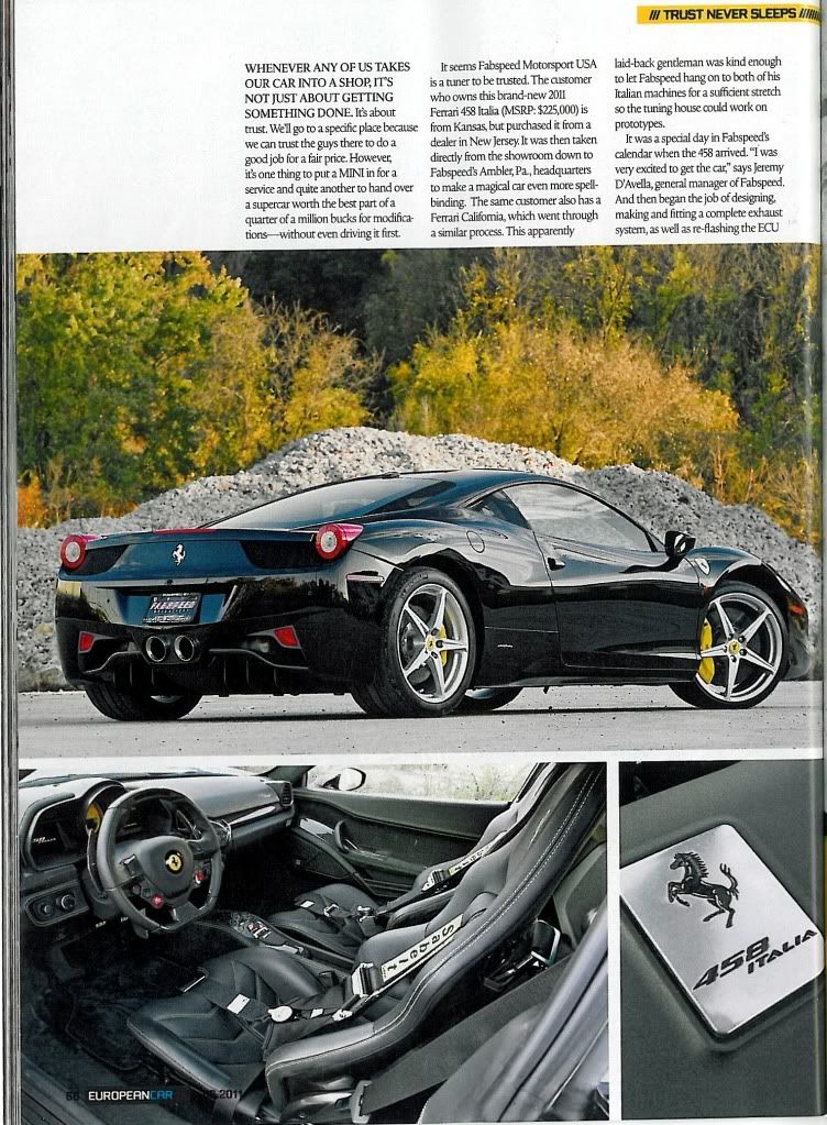

    Hello everyone, I wanted to share an article from the current issue of "European Car" that features a 458 on which we installed our performance package.

    The upgrades can be had as a package or individually. Below are the details of the full package installed on the car in the article and youtube videos:
    -Fits all Ferrari 458 Italia Cars 2010+
    -Fabspeed is the world’s first company to design and fabricate a full replacement, bolt-on - high performance exhaust system for the new 458 Italia.
    -This package includes Sport Headers, 200 cell German imported HJS sport race catalytic converters, Maxflo mufflers, Dual-style “458 Challenge” tips, and ECU Upgrade.
    -Power improvement +630HP/460 ft-lbs of torque to the crank.
    -With the full package installed, you will save 24lbs/10.9 kg compared to the factory system.
    -Constructed from high-quality, 14-16 gauge T304 stainless steel C.N.C. mandrel bent tubing for maximum power and sound.
    -Fabspeed only uses German imported, 200 cell per square inch OBDII Euro level 5 sports racing catalytic converters.
    -The Fabspeed sport headers feature a high velocity, 4-into-1 merge collector for improved exhaust scavenging and optimum flow.
    -Sport headers feature 1.875”/44.5mm primary pipes which are larger in diameter than the stock/OEM 1.5” tubes.
    -Maxflo Mufflers eliminate the stock/OEM valves and increase sportscar tone throughout the RPM range.
    -The package also includes Fabspeed’s Dual-Style “458 Challenge” tips with carbon fiber backsplash.
    -The EVOMSit ECU program is provided to smooth the power delivery and optimize air/fuel ratio throughout the RPM range.
    -Direct bolt-on application with no cutting or welding required.
    -Safe for emissions and will not void warranty.

    I like the 2 pipes instead of 3. I know it resembles the F40 but the 2 pipes look better in relation to the tail lights.

    Clearly I'm in the minority...but I like the 3 pipe look.

    Regarding the tips... you can add just the tips of you'd like. It is an is an easy fix if you prefer the challenge car look. Also, if you prefer the three pipe stock setup, you can retain them in conjunction with the rest of our system. It's your choice!

    That is really cool. The 2 pipes to me look more like the Ford GT. I'm sort of used to the three pipes now.

    I like the 2 pipes a lot, they give the back the 458 Challenge look *Thumbs Up*
