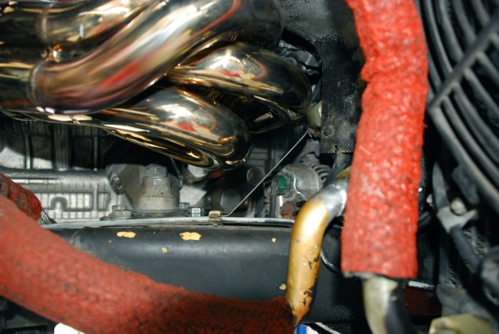

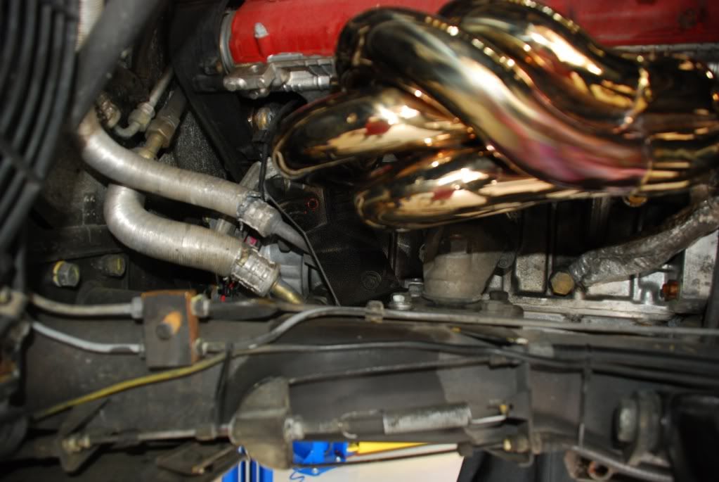

  16. Alex@fabspeed
    Alex@fabspeed Formula Junior
    Dec 6, 2006
    401
    Fort Washington, PA
    We do not supply header blankets with our headers. If you go with the creamic coated headers I have tested the difference of temperature with a infrared thermal scanner and have seen the Fabspeed ceramic coated headers are around 38 degrees cooler than the stock manifolds. We also have the new heatshields available for the alternator and compressor. Here are the pictures that I promised.
