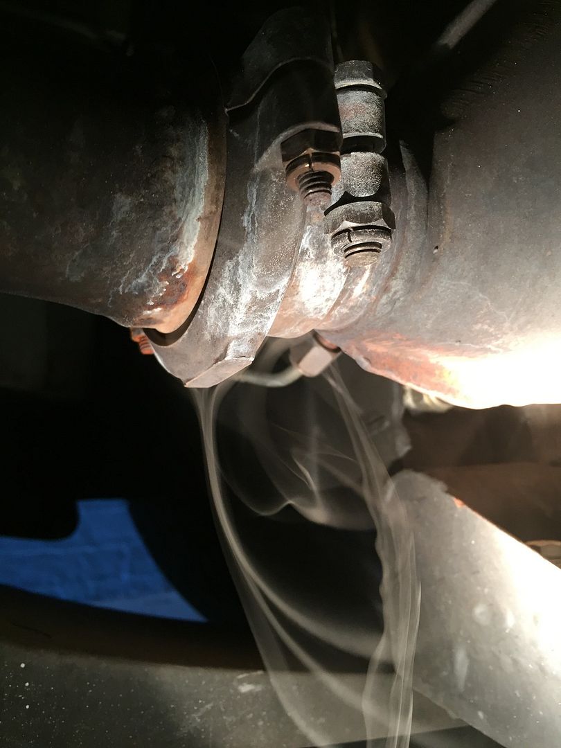

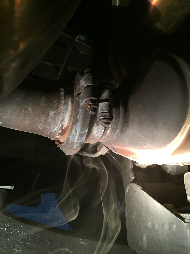

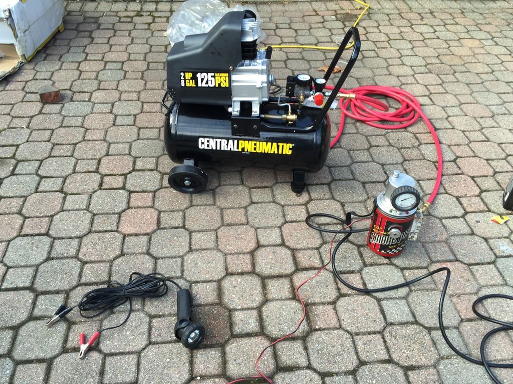

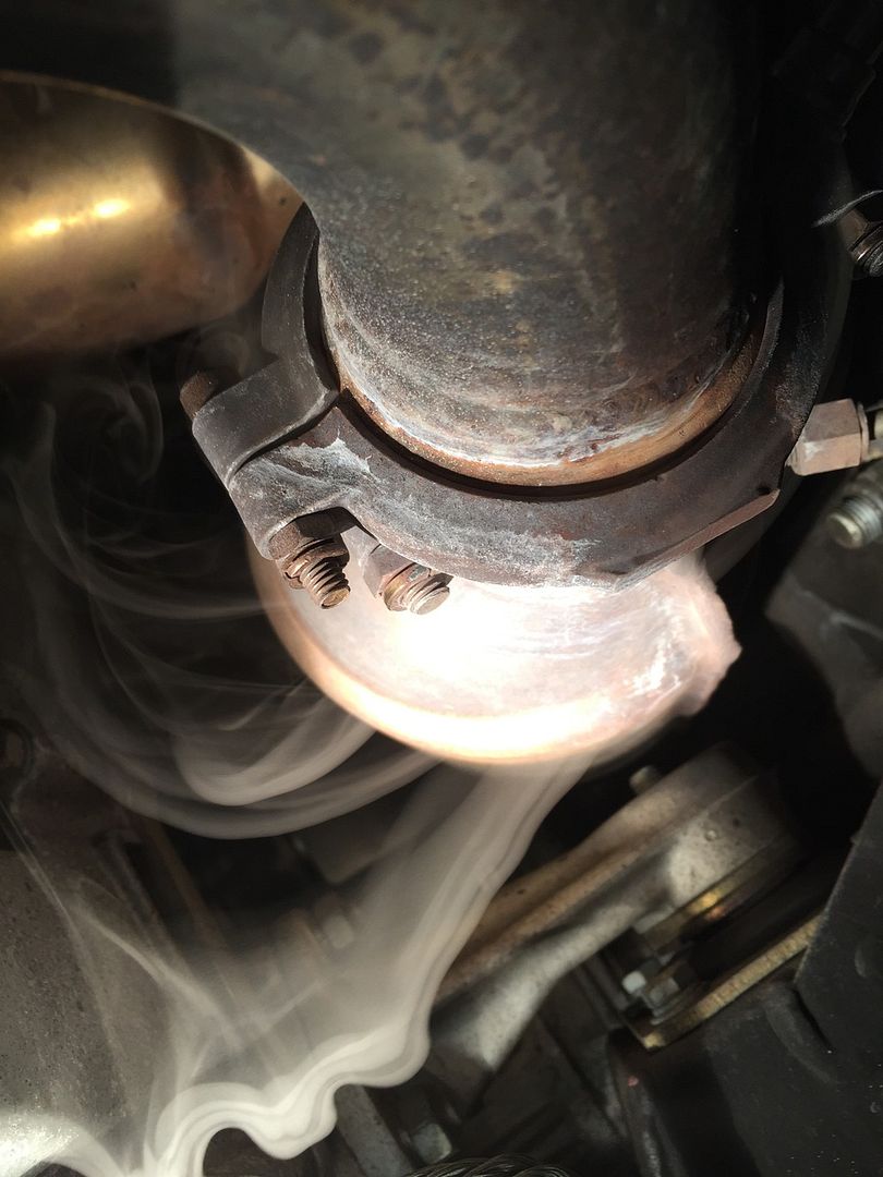

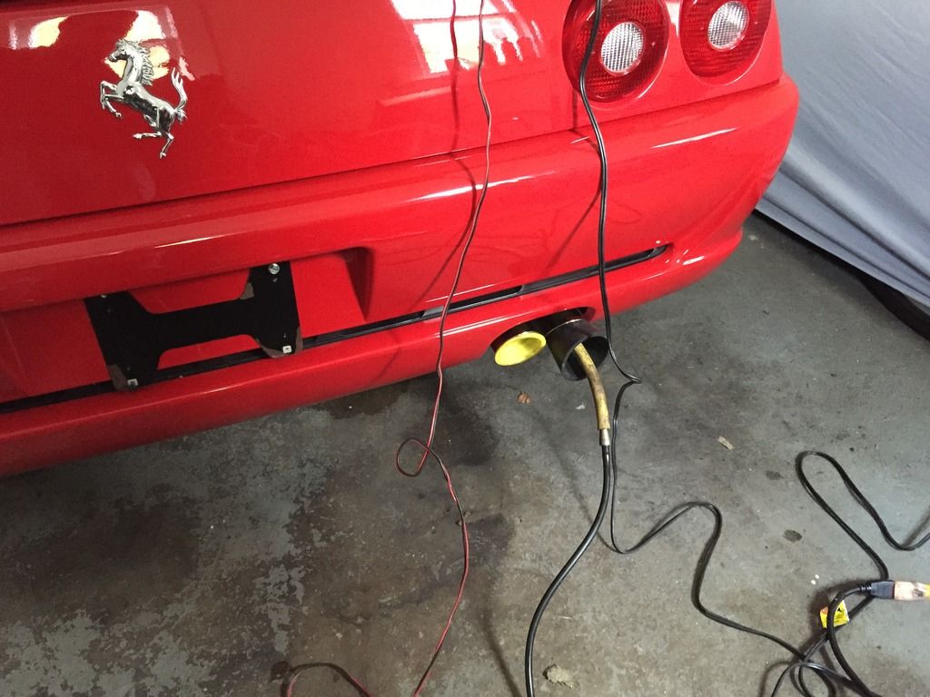

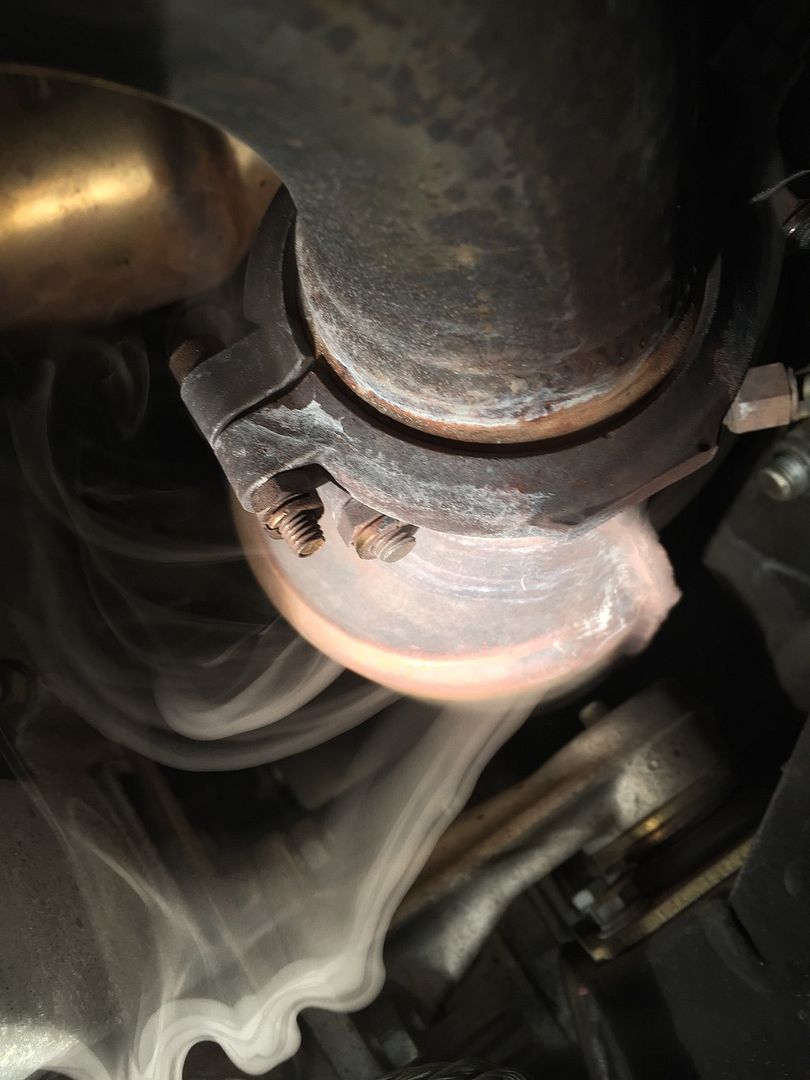

    Well, after more than a year since this thread was started, I believe I have a resolution to the issue.
    I first posted right after I got the car about a year ago. Thanks to the support of the online F community I have learned a lot in that time.
    With regards to this issue, the code is saying that additional unmetered air is entering the system, either through the intake or the exhaust.
    The ecu responds to this extra air by adding more fuel, hence the increase in fuel trims.
    With the guidance of fastradio, I performed a smoke test on both intake and exhaust.
    I found that there were several leaks in the intake system, the largest of which was at the connection of the intake elbow to the plenum on bank one.
    I haven't actually repaired it yet as I am waiting on parts, but this most certainly should be the culprit.
    Moral of the story; when dealing with fuel trim issues, a smoke test should be the first order of business, especially before buying parts.
    Will update again once repair is confirmed.
    Thanks everyone for your contributions.

    Mitchell Le
    seven pictures and all I see is the exhaust clamps. That leak has no consequences on fuel trim
