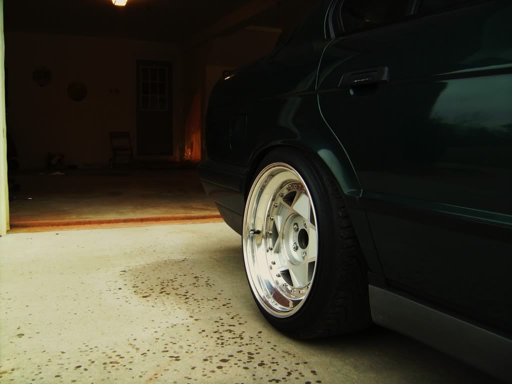

    Those wheels are so awesome that I'd consider buying them whether they'd fit or not :) If not, does the car come with them? lol

    you'll need to take a measurement to see how well they will work. I believe the offset for 308's is 11mm so if you have a 9mm and a 7mm then these wheels may stick out from the fenders. I don't think the 8 1'2 widths will be a problem but you would need to check the 10 1/2" rims. Make up a little cardboard templete and see how it fits. Good luck

    If the pics of the wheels are the ones you are inquiring about , I would make sure they're 5x108mm bolt pattern...the car they are on is an E34 BMW and the bolt pattern is 5x120mm. The offset you just posted would be a great offset for the E34 BMW.
    Hub size would also be a concern. The E34 has a 72.4mm hub. I'm not sure about the 308 hub?

    67.1mm

    I picked up my set of 17" 505s from a guy who had them on a BMW 535. I'm wondering now if these were the ones in the original picture?
    I had to change the inner and outter barrels to get the correct offset. Mine seem to be holding up well, but I don't drive it in the rain and definity not on salty roads.
