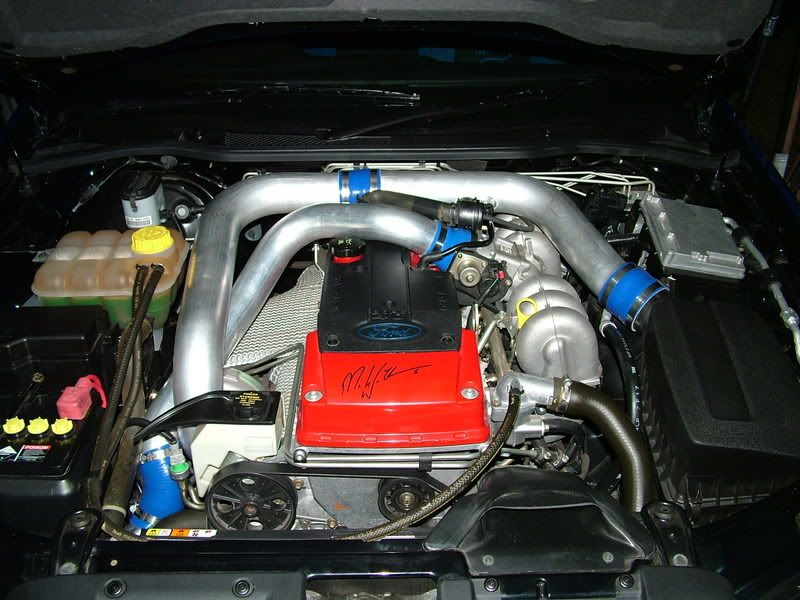

    on my daily driver, I am running 12psi boost with a comp ratio of 8.8:1, I have to use 98ron fuel as a min, the AFR is 14.7, at full boost the effective comp ratio goes to 15.98:1,
    for an engine that starts with 12:1 @6psi it would be 16.9:1
    I have a large intercooler on my car and would strongly suggest the use of one at the high effective comp ratios that is mentioned

    I have had the ecu adjusted via a flash tuner and run 305rwkws (409rwhp)
    sorry 328turbo you are correct, I had a look in my tuning records and I am running 12:1 going down to 11.9:1 at wot
    here is a pic of my daily driver
