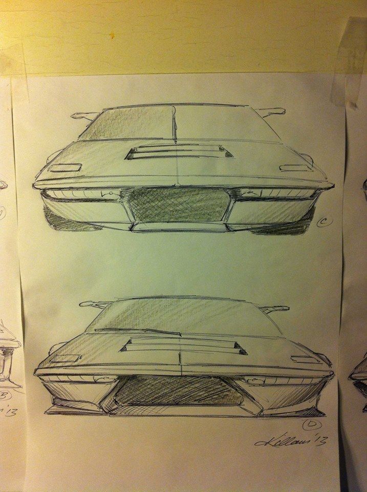

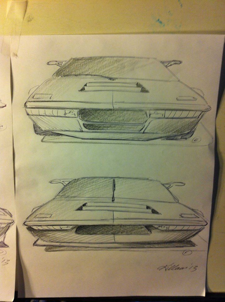

    Concept art by Frank Killam of the re-re-design of the Lp420 SVM Urraco

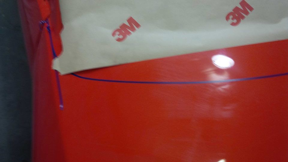

  15. TwiceBaked
    TwiceBaked Formula Junior
    Feb 19, 2012
    739
    Lake Arrowhead Calif
    Karlton Spindle
    And away we go... Once more into the breach..

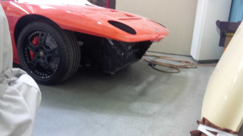

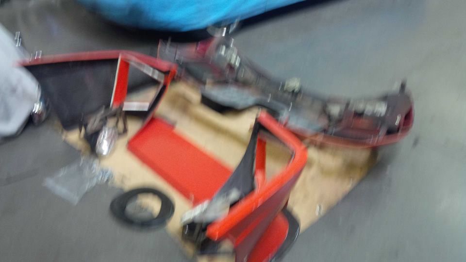

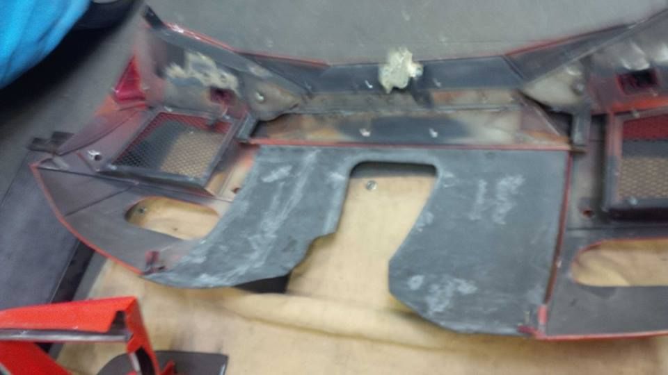

    Rear end removed so the re-re-make can start.
    Cut Line for the front end,
    Old 928 L@@king butt be gone
    More UGLY going away
    Front, headlights and rear off
    Front ready for removal.

    Those drawings are excellent. The reason: he used a frickin hand and pencil!!!!!
    That design is fantastic and very much like it came from the design dept at Lamborghini....decades ago.

    Frank is a true artist he just retired from BMW Design works.

    Alan Lee (he does not use his real name) took me for a very expensive ride... The suspension he built into the car would have never worked, motor was mounted wrong and drive axles would not have lived at any speed. Body work was also bad.. :(
    So we had to have the suspension re-done. To fix the rear clip it is cheaper to build a new rear end. Same with the front, the "Miura" like headlamps and pop ups he made would have never worked either.. The wiring he did was a fire hazard in the making but it too would have never worked.. The brakes he used both SAE and metric fittings and one banjo bolt was not even a banjo bolt. He used an ABS unit off an A8 you know what would have happened to a rear wheel drive lite car set for a much heavier 4 door quatro? Yes failure.. Unsafe if you could get it to run and even unsafer to try and stop it.
    The motor he build hand gernraded on first test.. The trans he build we have zero trust in.. So we are replacing it now so there is no issue.
    That said, we re-wired the car all new.
    Motor is re-built
    New trans on the way with better gear ratios and a better diff!
    With the dumping of the lower front clip and going back to POP up Urraco lights, I decided to go 180 and have new art done so we can make it more Urraco like I wanted in the first place not so much 928 looking. Even found a new old stock set of Urraco tailights.
    Ted's Rod shop has the car we have a budget I can live with to get it done.
    Yes I am looking for sponsors for wheels and tires and paint but even if I do not get any we will push this one done. Gone too far to turn back, not far enough to have a lawn artwork so we move forward.
    Now a little departure Danny Huseman (Huseman's racing) wants the body of the front end removed so he can construct the front suspension more like a race car and drop the body / hood on it. so teds is removing the body now. So when Danny gets the car in March he can knock it out. He already has the measurements and how he wants to do it. its just a matter of getting his shop time. The cut line for the body is just in front of the windshield so it will not show much but will make front end servicing very easy.

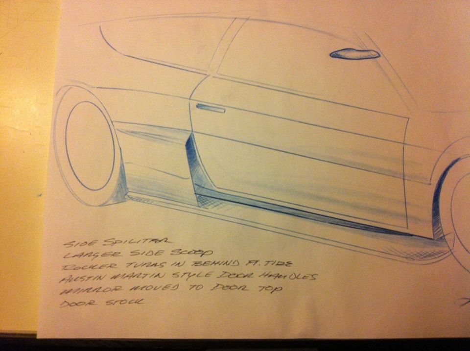

    I know you have your own vision but I will suggest that you put a Urraco Bob style front air dam on it. The car will look deadly with it and would go well with your flared fenders. For the rear I would go with a stock look but with a modern twist of a central exhaust tip like an Aventador and some flush taillights. I thought the rockers you had were good and would leave them. Go more modern retro and it will turn heads for all the right reasons.

    Agreed... Its what I wanted and Alan did his own thing..
