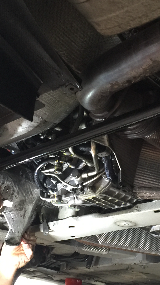

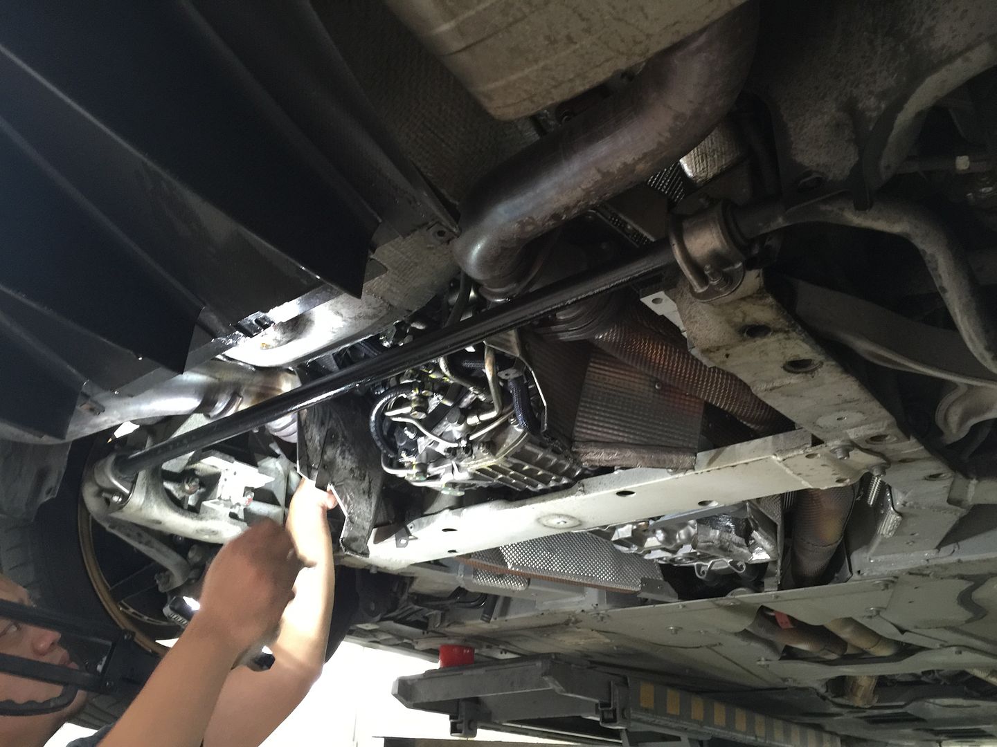

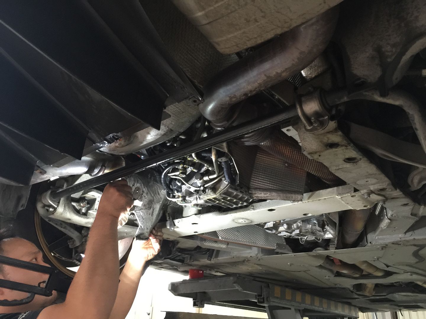

    its like a 100 degrees out here, im driving a little hard, but not too hard, just got back to the city from a mountain run, all is well, until i notice some steam from the next lane, so i thought.....
    One of my transmission hoses burst, and i lost all transmission fluid along came the lack of hydraulic pressure, so i was stranded on the left most lane in the center of downtown, not fun.
    Flatbed it to the shop and they said i can go back up in the evening, yea! :)
    but those hoses are fragile, it happens on 599s and 458s too, but nothing u can do, till it bursts :(
