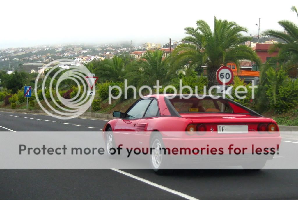

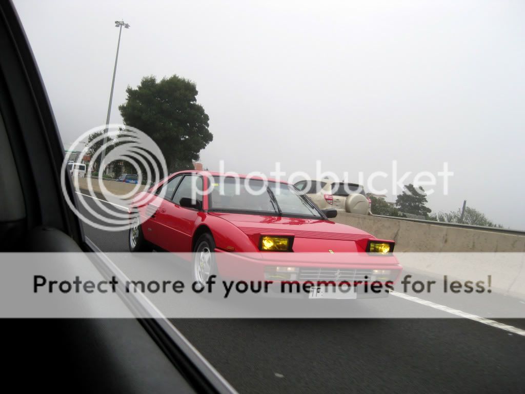

    Hello everyone, a friend of mine, has a Mondial T, and he need to change the clutch. I am looking in online shops and discovered that there are two types of clutch for a Mondial T, a single disc and another, much more expensive, with two disks. Is there any way to know which one is the correct for the car??
    http://www.eurospares.co.uk/userImages/033/Large/033_021A.gif
    It is a Mondial T Coupe, 1992, is the first time that will Be change the clutch. Clutch Factory still
    thank! :D

    By the way, great looking t coupe.
