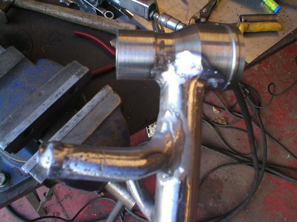

  9. Dingbat
    Dingbat Rookie
    Oct 27, 2013
    34
    SE London
    Bill Russell
    Hi All
    Today I repaired my side water pipe using the same method mentioned above, I had my friend down the road put an almost ninety degree bend on the end of a section of pipe and welded it onto the original end section, the part that connects to the heads, it came out very well unfortunately although my water pump pipe looked ok after blasting with just the one feathery hole it turns out the hole thing is like tissue paper so I am having another bit of tube bent up and will graft the old fittings onto it, many thanks Bill Russell.

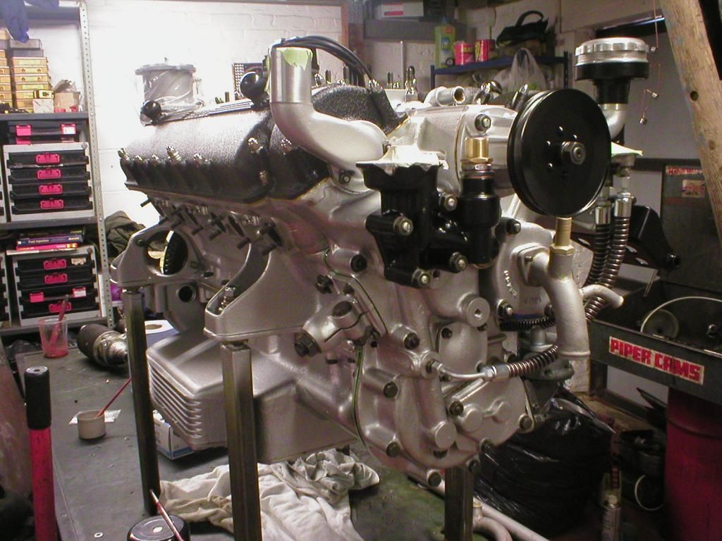

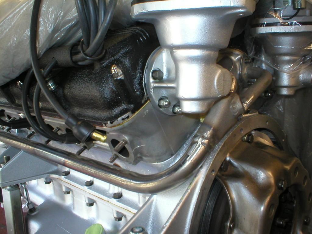

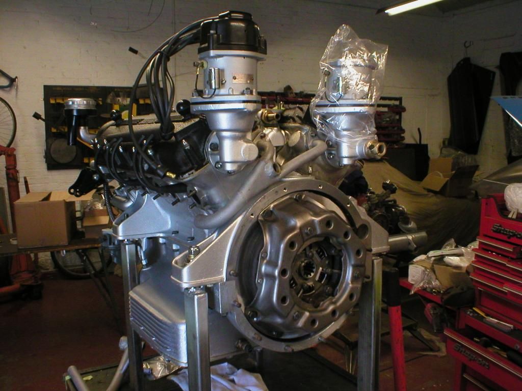

  10. Dingbat
    Dingbat Rookie
    Oct 27, 2013
    34
    SE London
    Bill Russell
    #10 Dingbat, May 14, 2014
    Hi All
    I thought a couple of pictures may elicit a reply in regard to thrust washers and things, I have been told the part of the fan assembly I need is not a Peugeot part so I suppose I will have to have a new boss turned up.
