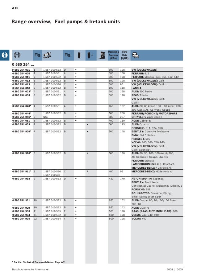

    The fuel pump is just amazing. I realize this is common on Mondial and 348s. The price to buy factory parts is obscene. I will use my skills of fabricating, and get it going.
    I will post pix of progress. The good news is if I decide to go forward, it gets a full new interior and new top. New tires, battery and a motor out ( timing belts have aged out) the car has 33k miles. I got it from the 2nd owner who bought it in 1999.
    Again, if anyone can give me actual fuel pump specs, it will make sourcing parts easier.

    The Mondial T fuel pump is Bosch 0580252011 and the number on the Bosch Box is 69535.

    I would find a mechanic/shop that buys from World-Pac. That company sells oem parts and can, possibly, supply most of the stuff would need to get it running. Not sure but it looks like the FI parts are all Bosch and, if so, are probably found on other vehicles.
