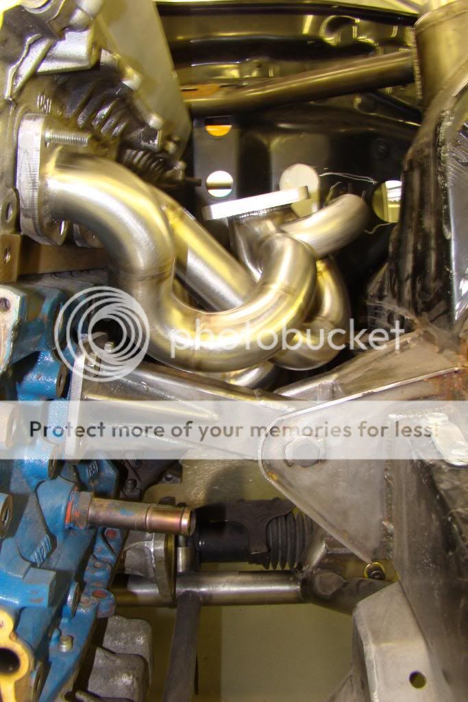

    Someone of another forum got an inconel manifold custom build for his straight 6 by the same company that makes exhausts for Mclaren F1 (the F1 cars, not their road car) and NASCAR. £3600 for the entire thing. No special friends at the shop either. Make of that what you will.
    Here are some pics of it:
    http://i499.photobucket.com/albums/rr353/neiloldham/0000000032.jpg
    http://i499.photobucket.com/albums/rr353/neiloldham/002-23.jpg
    http://i499.photobucket.com/albums/rr353/neiloldham/004-13.jpg
    http://i499.photobucket.com/albums/rr353/neiloldham/003-19.jpg
    As for the normal stainless steel comment, isn't SS301 normal stainless steel? Plenty of manifolds are made out of that and it's a lot easier (and cheaper) to work with than inconel.

    OK, so that's $6100, only 20% off there. I was referring to the US. Things are way less in the UK. Also you mention straight 6, we were talking about a V12.

    Forgetting the fact that a non insulated manifold in a street US version 550 or 575 is going to melt a lot of stuff.

    6100 for an inconel manifold, yes. Inconel is quite a bit harder to work with than stainless steel.
    If it's really so expensive in the US, you guys are getting raped. The above is done by a company that normally only works on F1 cars and NASCAR, and it was a one off exhaust (with the possibility to get 5 more made at a reduced price, £2600, if he wanted or could find enough people who wanted one).

    Now you're just nit picking. Even I could heatwrap an exhaust myself or fit a manifold blanket.
    Anyhow, sort of a moot point seeing the OP isn't interested.
