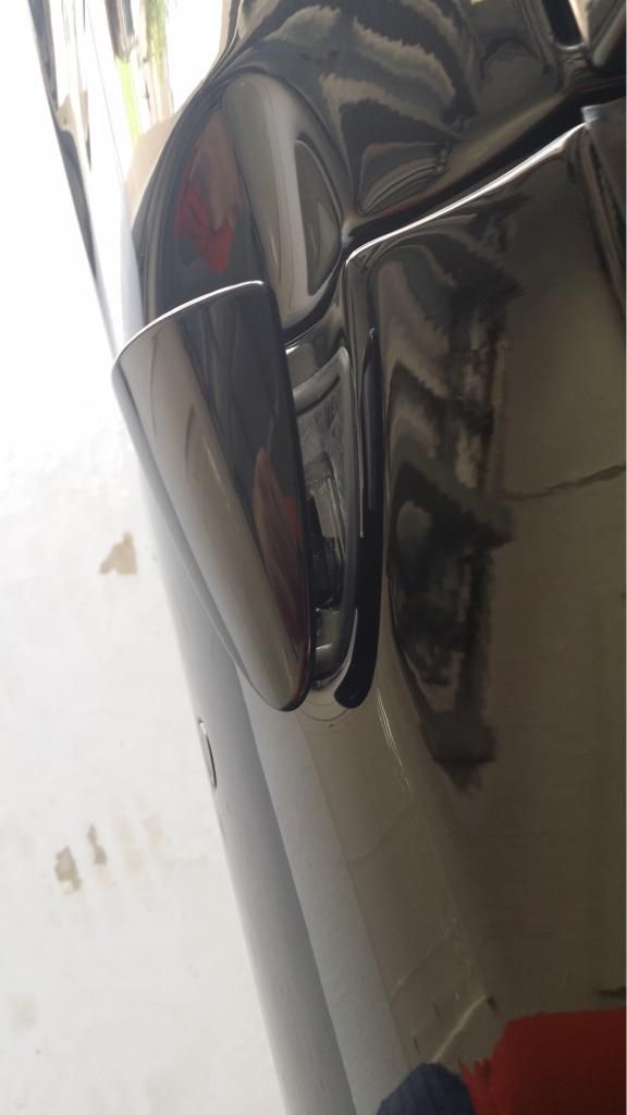

    2) My passenger side door handle does not fit flush with the door like the one on the driver side. For some reason it feels loose and funky however it works as normal. Anyone seen this before?

    Probably just a broken tab or something like that on your door handle. Have a tech refit or get a new part if it bothers you enough. While you are at it, they do sell carbon versions of the door handle that look awesome!

    Here are some pics of the car and the door handle. Nero on bordeaux love the color combo lots of options

    Door handle is probably a cable adjustment. Easy to do but you have to take off the door card to do the outside handle's cable.

    Door handle will be like that when your passenger tries to pull really hard when the door is still locked. Been there! Dumb biatch. Need to pull the interior cover and align the cables + cable attachments.
