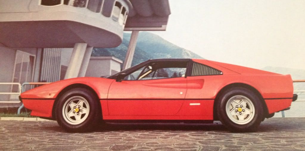

    I have the '77 GTB/GTS brochure book, all the cars in the book have black rockers.

    George, can you post a pic of the brochure?

    And now as I see this picture I see no black at all! On a '77!
