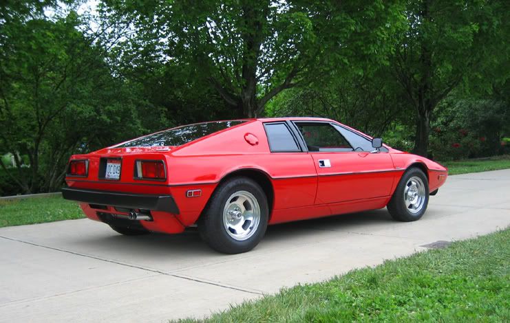

    I can post links -- not sure if I can post pics here without subscribing--
    Here's the red one:
    Here's the white one:
    The red one is in very good overall condition, and I have had it for a while. The picture of the white one was taken right when I bought it last December, and I immediately removed the interior to retrim it, and the car has spent the time since then either being worked on or sitting, so I have no good photos of it yet! I need to hurry up with it!
