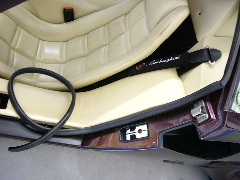

    Since the leather is getting loose I want to remove the dashboard, is it possible without removing the windscreen?
    I remarked that it is somehow fixed near the windscreen but didn't find any screws, the rest just lays on the traverse frame and is holded together by the already removed pieces.
    I also saw that the connection hose from the AC to the box splitting the air was loose, now wonder it didn't really work...

    The Countach dash is removable with out taking the windshield out.

    Also look for retaining hardware on the inside of the dash ducts, at the base of the windshield, and you will need a curved 8MM wrench to loosten.

    Thanks Gary, I supposed this when I removed one of the ducts I saw this 8mm stud and screw, but before tearing and pulling etc it's wiser to ask if someone has made already the experience.

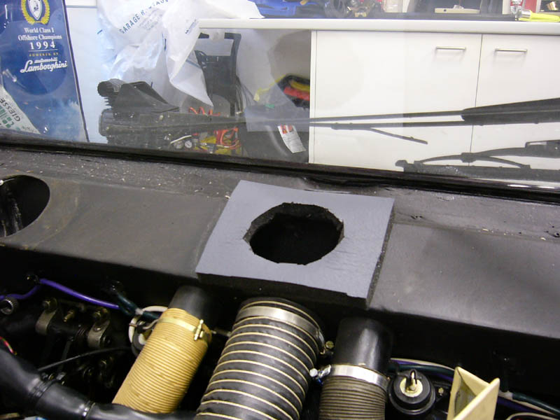

    The first time after 23 years of existance the air hose to the paasenger foot room has enough room after I cut out a small piece of the fuse box plate... that was a lot of chianti those days.

    Seems that 23 years ago someone drunk too much chianti during lunch time, else I can't explain why a 89mm hose was used between the AC-Unit and the air splitting box.
    Well it's corrected now, the correct 82mm hose is installed and fixed appropriately. The wires will be rerouted as well and fixed thoroughly.

    Dashboard is back in the car since last Thursday, looking at the pictures I took at removal I can recognize that it was not installed properly, it was not fully at the windscreen.
    http://www.countach.ch/Dashboard/P1050084.JPG
    The reason was simply the bad mounting, the small alu piece in the right vent which holds the stud was not in the correct position, like that it's impossible to push the dash fully to the front
    http://www.countach.ch/Dashboard/P1050089.jpg
    Here the problem in detail: obviously the alu plate is not in sync with the fibreglass, so the stud was blocked in between
    http://www.countach.ch/Dashboard/P1050103.jpg
    Now it fits perfect, I just wonder why the made it that complicate, there would have been enough room to place these two studs outside the airbox feeding the vents.
