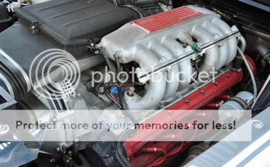

    Main priority is the engine and emission system. Engine should be:
    "F113A Bosch K Jetronic (mechanical gasoline control and electronic emission control) and a compression ratio of 9.3:1"

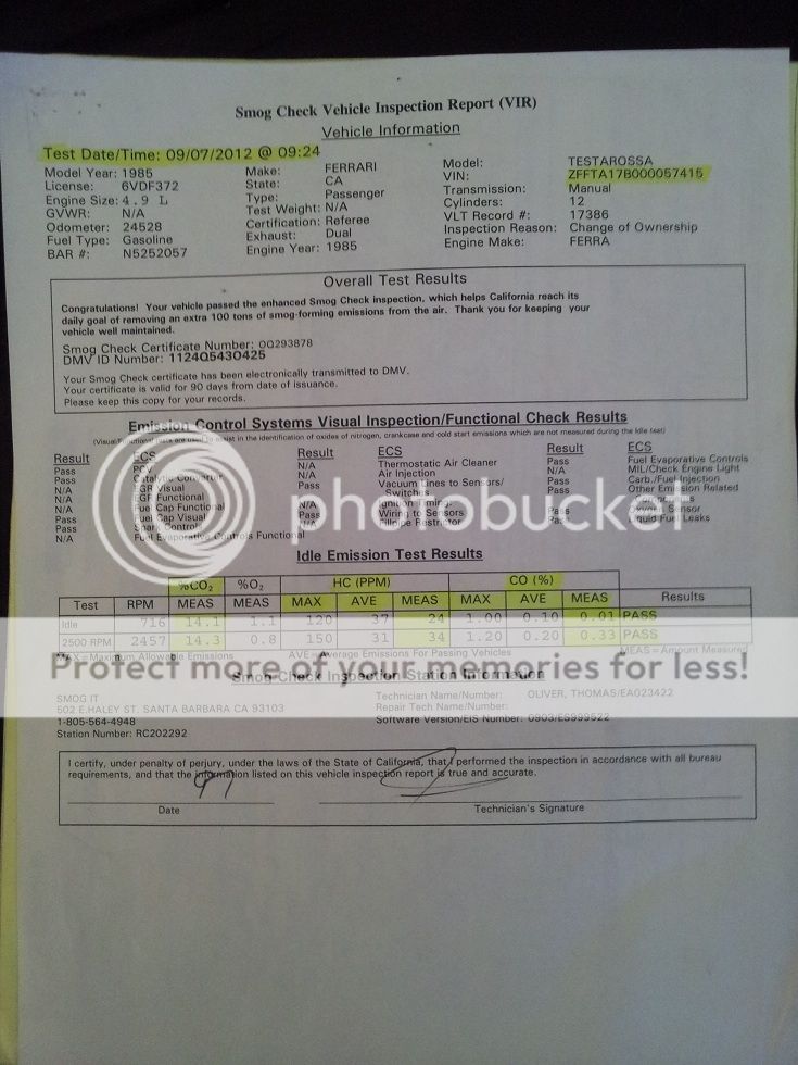

    The smog certificate
    http://i412.photobucket.com/albums/pp206/vanvinkel/85TR/1985_Ferrari_testarossa_misc_04_zpsfa6d162e.jpg

    the smog check vehicle inspection report I wonder a little: there is in idle of max. of 1 % CO and at 2500 rpm 1,2 CO. those readings an engine without electronic smog control and also without cats can comply with. only the HC with 120 and 150 you can nearly not reach with an engine without cats.
    in germany we have for cars with cats in idle max. 0,5 % CO and at about 2500 to 3000 rpm max. 0.3 % CO. but in 1985 the rules have been much easier, so you may have much more higher readings.

    The CIS plumbing changes (if still present) would typically be adding a line from the WUR control pressure port, thru a frequency valve, that (eventually) returns to the tank (a clue would be having 2 banjo fittings stacked on a single banjo bolt location). If you can take a photo of the plumbing between the WURs and the fuel distributors, would be glad to cast an eyeball over it (really requires removing the air filter box).
    Are you familiar with the CIS plumbing changes on the euro V8 models to convert them from K-Jet without Lambda to K-Jet with quasi-Lambda that have been posted here before? Your modifications (if still present) would be done using the same architecture.

    Based on the smog cert my first thought was that co was very low, the "return to idle" when blipping the throttle is too slow and from my knowledge that indicate lean mixture. The only problem with the tune of engine right now would be transition from idle and too high idle (1050-1100 rpm)

    Yes, I only found one o2 sensor. It does not look like the plastic pipes from the WUR go to the tank(s), both seem to go into the distributors, they have another pipe that just connect the two WUR's.
    The o2 sensor can be traced into the relay and likewise the blue box (ecu?) sitting together on the right inner fender (in the pix as well). Did not trace it towards the frequency valve.
    Would it be correct to assume the (extra) control system in short is the added ECU, the relay for the o2 sensor, sensor and the frequency valve plus the associated wiring?

    From the pix it seems like just the driver side fuel distributor is affected. Maybe that was enough to reach the emission targets?

    The modification affects the control pressure -- since you have a line joining the two WUR control pressure ports, the control pressure acting on each fuel distributor is the same -- so even though the FV is mounted to ports of only one fuel distributor, its effect is felt equally by both fuel distributors.
    Not a horrible sin, but not great -- sort of similar to the situation on some TR exhaust systems where the exhaust from only 3 cylinders in a bank are sampled. It does count on the bank without the O2 sensor being adjusted correctly.
    The connection on the side of the fuel distributor (the arrow in about the middle of your pic) is a return port that (eventually) goes back to the tank (i.e., the WUR and the FV are both returning fuel to the tank at that connection). The other connection (the arrow on the right side of your photo), eventually going to the top center port of the fuel distributor, is the control pressure side of things.
    Normal -- this way, the control pressure is exactly the same for both banks (and you only need one FV if you want to change it).
    Yes. You should be able to just remove it all (using a couple of stock, shorter banjo bolts), and be back to the stock euro F113A configuration, but, most likely, it will need to have the manual A/F tweaks checked/reset. If you want to run active precats and/or cats (and not overheat them), the A/F ratio adjustments need to be per spec (lean side). Do you know if your precats and/or cats are intact internally?
