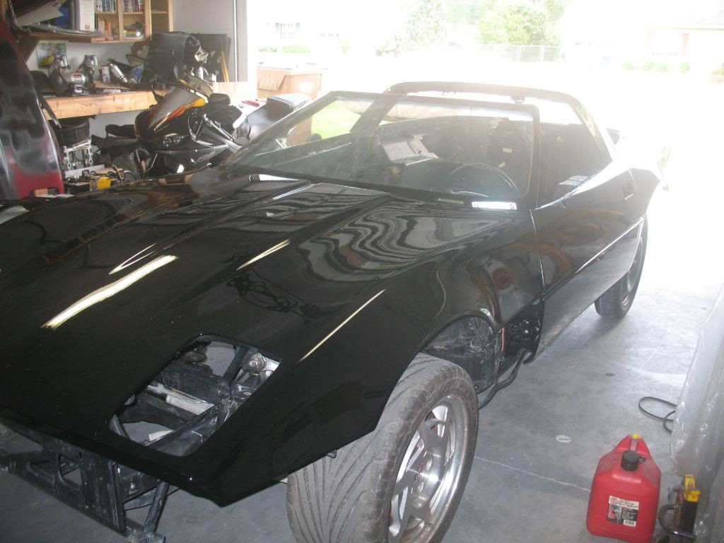

    Oh ok duplicolor you should Post that on their website!
    They have a restoration challenge and they are giving away money! If you want the link PM me ill send it to you.
    As for my corvette I used all S/W stuff primers up to clear.
    Here are a few I tore the car apart, sanded it all down fixed a few areas of the fiberglass that had minor rock chips but needed repair and then took it in for paint.
    Had it shot at my local Ford dealer after I had struck up a deal with there painter that I bring the paint He did the painting for $200 then I brought it all home and did the cut and buff myself.
    I think the black turned out nice.
