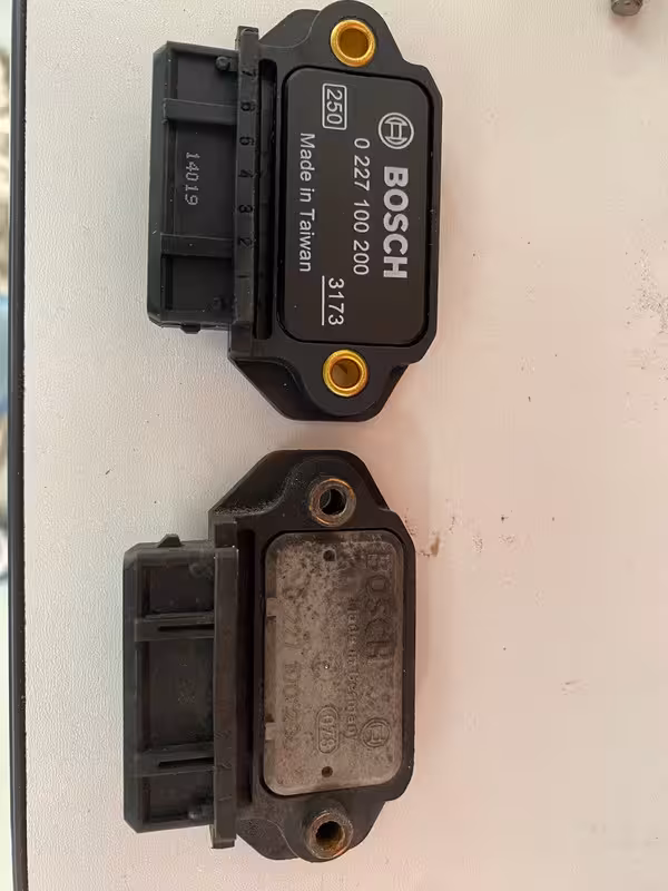

    I have ordered new pair of coils and ignition modules and swap those once new BOSCH components arrive. Car seems to work normally with old components when temps are lower and driving in open roads instead of in urban traffic. When swapping new stuff in I will likely also get heat sink anodised to get some bling-bling into engine bay.

    I assume the root cause has been addressed as car has working nicely after changing plugs (NGK DR8EIX), coils and ignition control modules.
    Thermal paste under the original ignition control modules was completely dried out and pulverised, naturally.

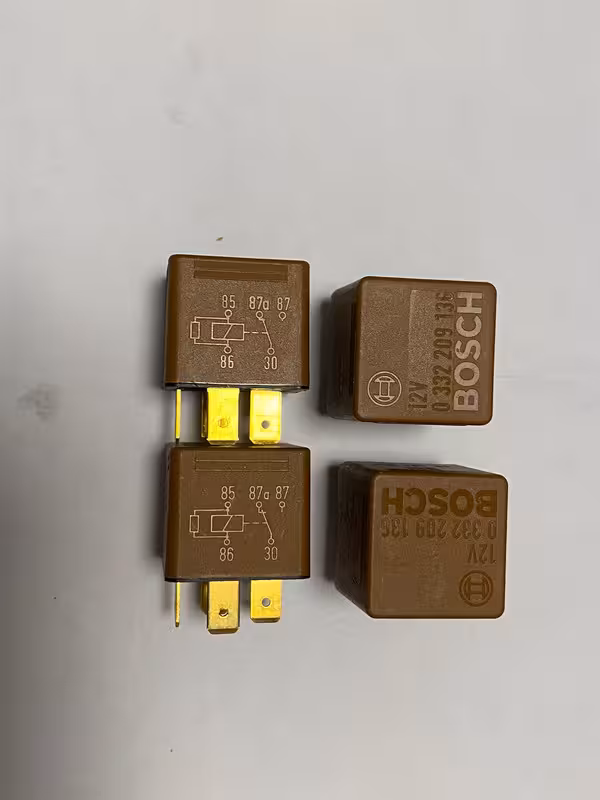

    Now blue overalls on and 348 onto QuickJack ride. As a paranoid person I just happen to have two new, shiny sensors on the garage shelf. I hope Magneti Marelli's manufactured in China for KIA are working well enough for F119 also.
    And just in case 4x new Saab 9-3 / GM "Brown Relays" are on the way from the land of the Saab and new set of spark plug wires are on route from Brexit Islands. When in doubt, throw parts until problem is solved! :)

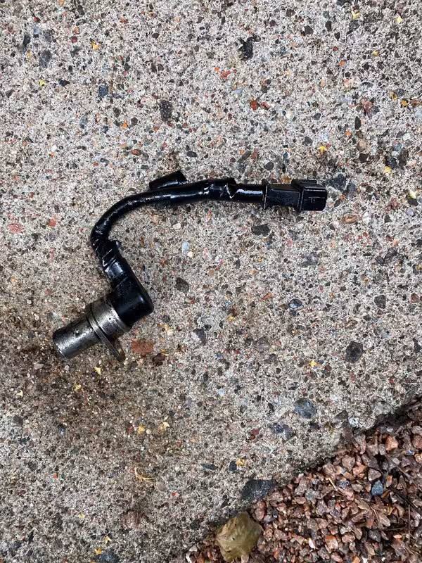

    If the bank 1/4 sensor looks like below, is it time to change?
    Electrical tape... Why? It is a 30€ / $35 component <Palm Face emoji here>.

    Bunch relays arrived from the country of Saab. Just in case.
