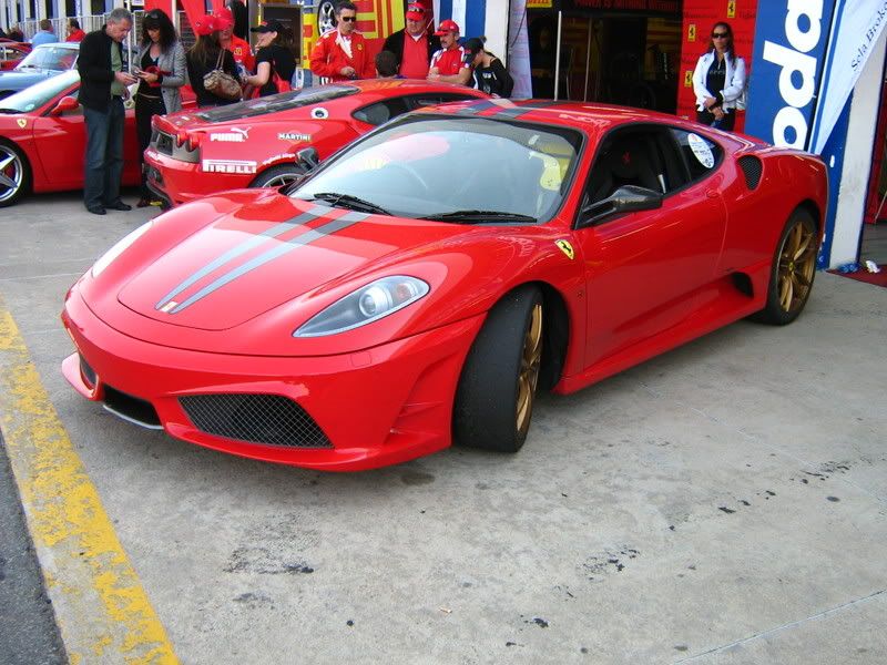

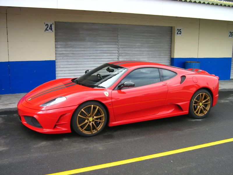

    Scud can run with slicks, guy down here raced his car at Kyalami with slicks and had no problem, let me tell you he was going much faster than 160 km/h...I have also been in the car around the track on slicks and there were no problems at all.
    So where all these stories about electronics come from I really dont know...
