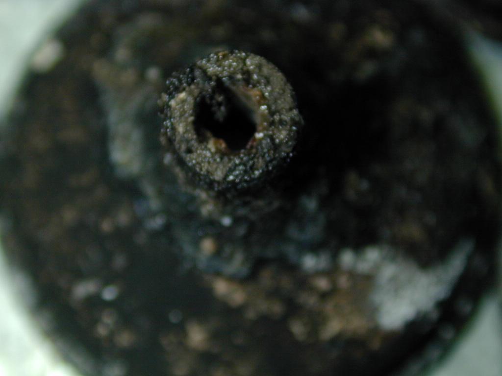

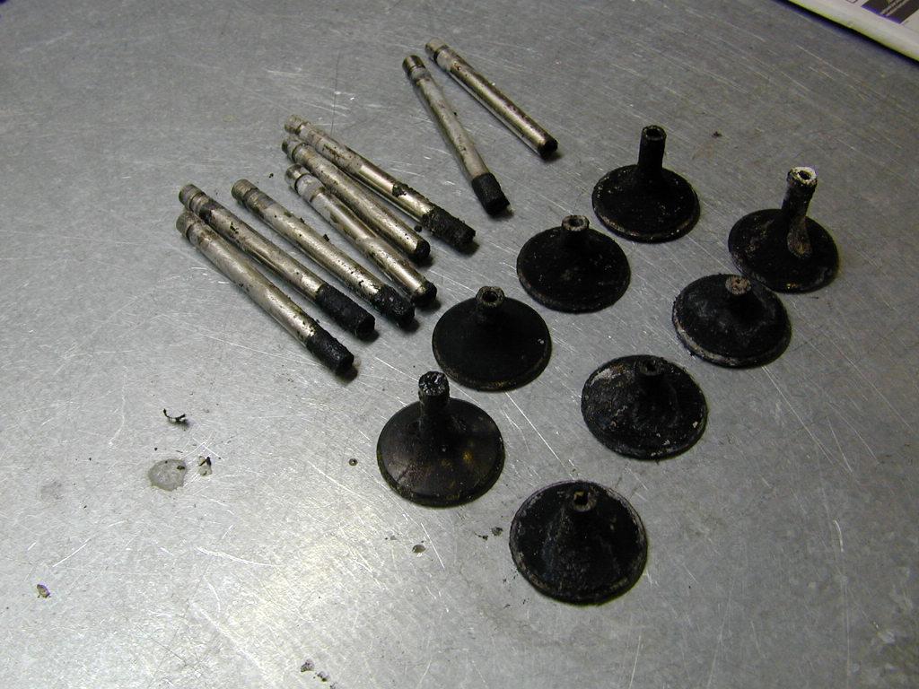

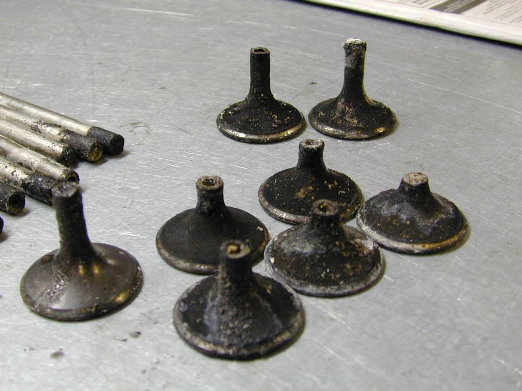

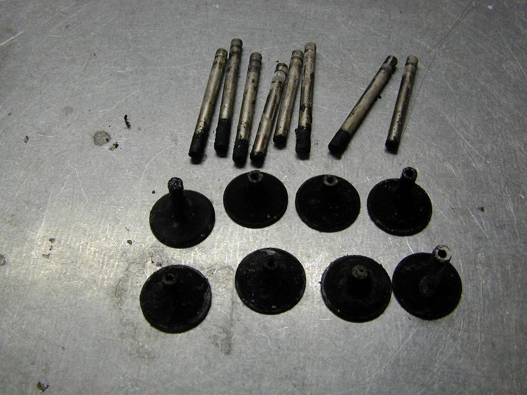

  10. Aircon
    Aircon Ten Time F1 World Champ
    Jun 23, 2003
    100,524
    Melbourne, Australia
    Peter
    http://www.pless.com.au/cars/gt4/rebuild/images/DSCN0482.JPG
    http://www.pless.com.au/cars/gt4/rebuild/images/DSCN0479.JPG
    http://www.pless.com.au/cars/gt4/rebuild/images/DSCN0478.JPG
    http://www.pless.com.au/cars/gt4/rebuild/images/DSCN0477.JPG
    http://www.pless.com.au/cars/gt4/rebuild/images/DSCN0475.JPG
    it can happen at any time. some cars did it during pre-delivery!
    i've also heard of a car with 200,000m with sodium valves still in it.
    when i bought my GT4 last year, i couldn't change the valves fast enough.
