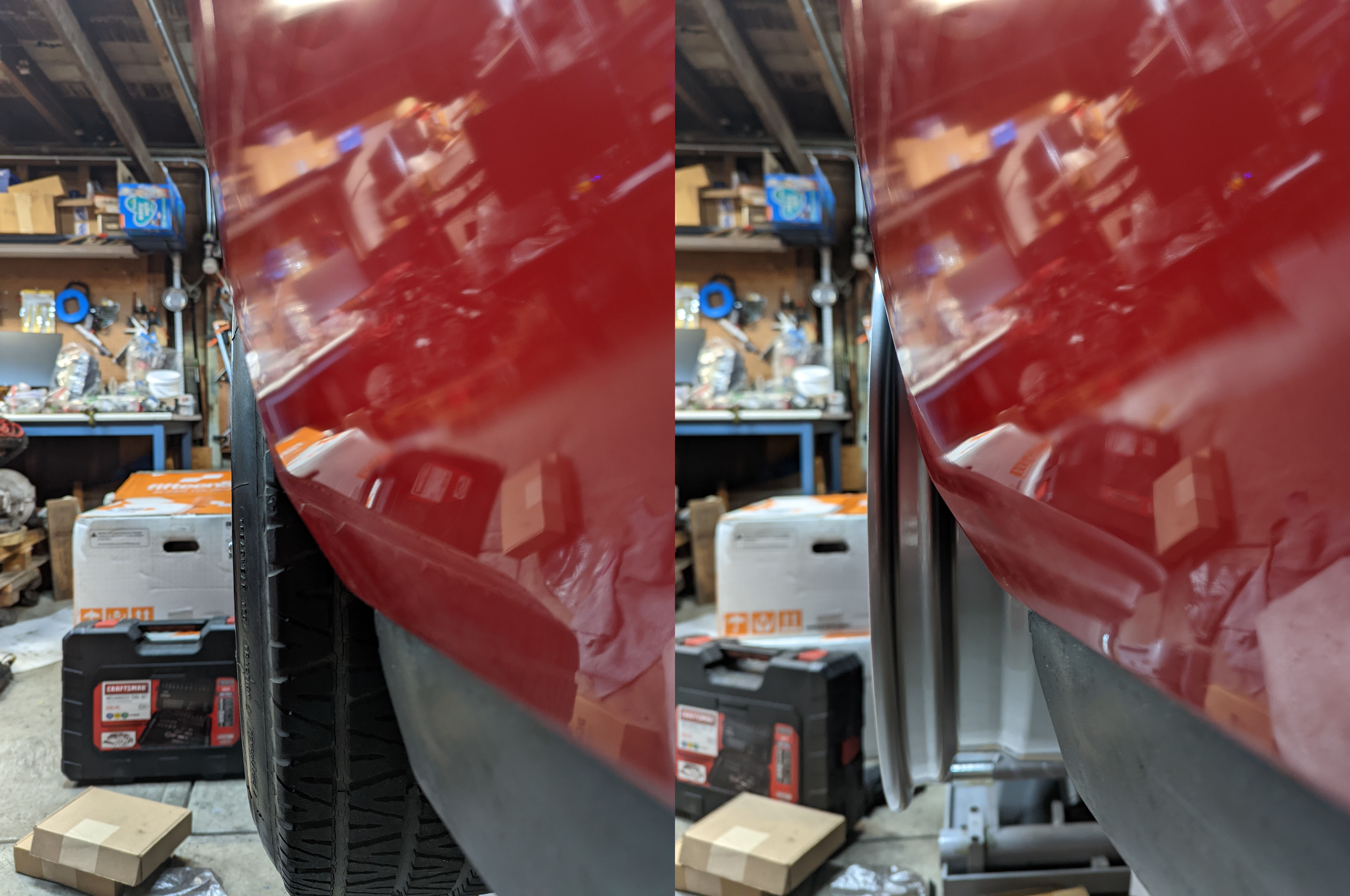

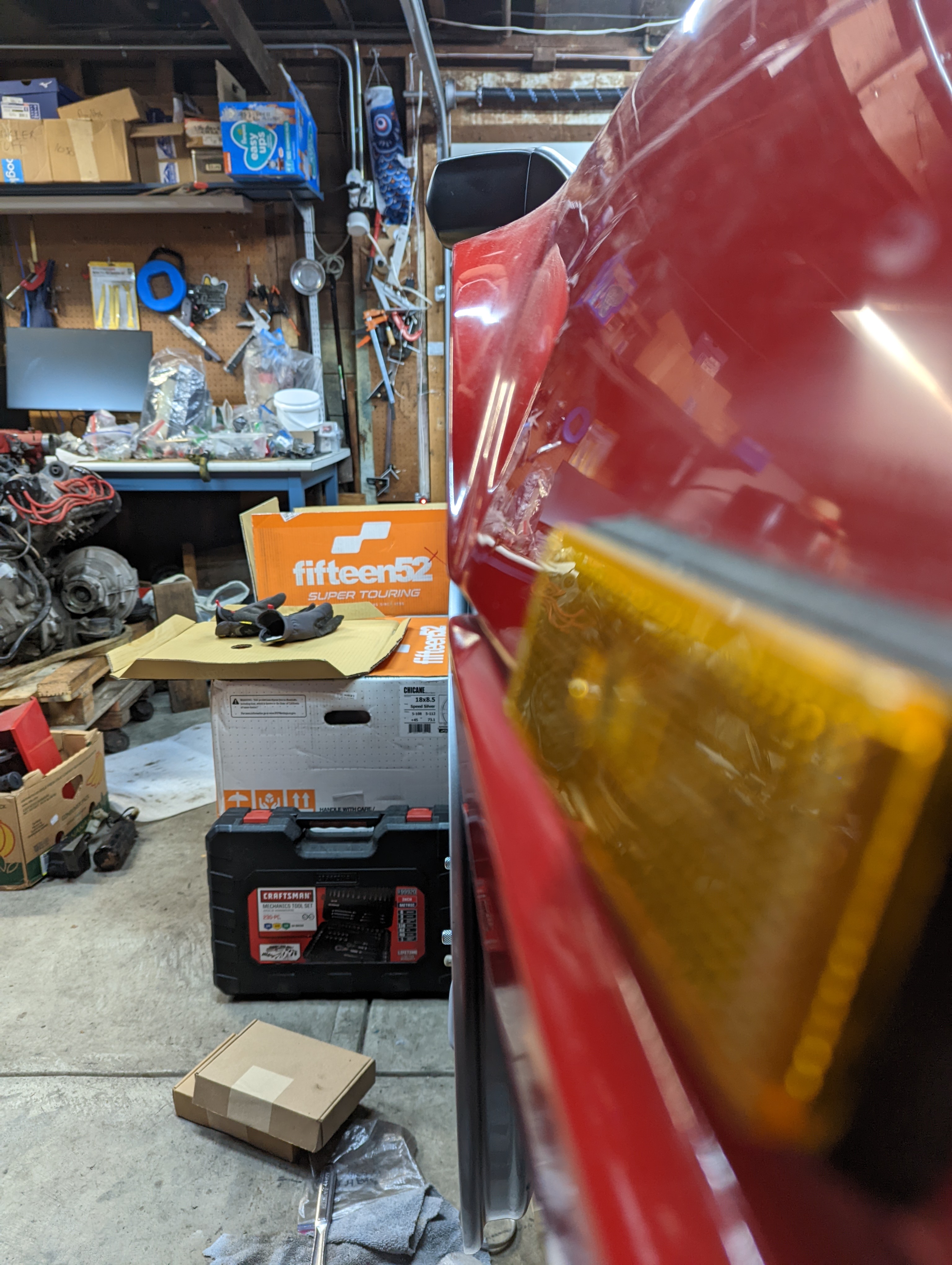

    Huh. You should absolutely pick whatever wheel dimensions you want for your project but my gut feel is that 7" width seems a bit narrow for a 17" rim. I fiddled with this a bit and did test fitments before going to 18s on my Mondial. Maybe I'm not accounting for the offset difference, but here are my thoughts
    I believe the design goals you have are as follows (please confirm)
    - Keep the stock look but in a larger, more standard diameter.
    - Retain a similar overall tire diameter once mounted vs stock. For 220/55 VR 390, that was 25.1" according to my calculations. This means the speedometer/odometer will read correctly and won't require adjustment.
    - Don't overdo the width so the wheels/tires stick out beyond the stock fenders like a Jeep or UTV.
    Thoughts
    Q: What tire size were you aiming for?
    - To keep the stock 25.1" diameter, Tiresize.com says we are talking about 205/50R17 tires. Those are pretty tall and skinny and selection looks to be pretty sparse although the a few "high performance" tire choices (at least those common in the US) like Michelin PS2 are available. Curiously enough to me, these are pretty pricey compared to other tire sizes (even 18s).
    https://tiresize.com/tiresizes/205-50R17.htm
    - I think this cost/availability is much higher with a more common tire size like 225/45R17. They SEEM to fit 7" wheels so that might be a good choice as the rubber options are less than half the cost of the 205/50R17
    https://tiresize.com/tiresizes/225-45R17.htm
    - It should also be noted that most aftermarket wheels seem to be 17x8 or 17x9... but this is also accounted by a different offset (20-45mm), whereas you are sticking with +55.
    - Looking at alot of the pictures I took on fitment (around https://www.gunn.com/mondialEV/37.jpg to https://www.gunn.com/mondialEV/45.jpg), I noticed that the stock wheels/tires bow out a bit more because of the metric tires taller sidewall. Going to a larger diameter wheel, the tire sidewall height (aka the aspect ratio) needs to be reduced to retain the tires overall diameter AND the wheel width is widened. If you enlarge the wheel diameter but keep the same width for the same outer tire diameter, you'll end up with a narrower tire.
    - Unlike you, I no longer need to keep the stock diameter tire since I'm no longer using a stock odometer/speedometer OR stock ride height/suspension. As long as I can clear a big brake kit and the tires don't stick out beyond the fenders, I'm good. I originally went with 225x40R18 to go with my 18x8.5" wide wheels, but in hindsight I'll probably choose 235x40R18 tires next. They'll still fit on my rims but will offer an upgrade in traction b/c of the wider width. Visually, they'll also fill the wheel well better which is a more modern stylistic choice -- unless you are doing a safari build. In that case, go knobbies ;)

    Gunn thanks for your feedback. I am personally, and for purely stylistic reasons, not a fan of 348 wheels on the Mondial ( I don't think their style fits the car's styling) but slightly larger rims do improve the look of the car, by today's expectations.
    The original TRX rims were and 7" wide, the overall tire 240mm wide as measured, with an offset of 51mm. By the way, the Superformance 7Jx16 repros have an ET48 as measured on my set of wheels.
    Agreed that the 17" rim would be of slimmer proportion than the 16" with the same width, but the overall wheel with the same diameter would still be of identical proportions on the car, albeit with a lower section tire. That's the only thing that theoretically would improve steering response a touch. It would also degrade the ride, as would the resulting heavier rim.
    For information, the 8s and QVs came with 240/55VR390 all round, and on my car, with the specified tire pressure, I measure an SLR of 309mm in the rear, which was likely due to wear as the suspension drawings mark it at 314.
    Regarding the design goals:
    - Keep the stock look but with a larger diameter as you said
    - Keep the SLR very close to stock so the milage counter won't be affected too much (it can't be adjusted) and the speedo not beyond its adjustment range.
    - Additionally, keep the overall diameter where it was to avoid wheel arch strikes on bump as I don't know how much clearance there really is. It also won't affect braking performance as the effective radius (SLR) will be the same.
    - Keep the outer tire side wall within legal limits in relationship to the wheel arch (and to minimise pedestrian risks), plus keeping the inner side wall and rim edge where it was to avoid and contact with suspension components, especially in the front while steering at full lock, and in and bump/droop conditions.
    Additionally, keep the offset where it was so the steering feel doesn't get affected and no toe-in trials are necessary.
    Here is my tire choice -
    The 55 section 16"s are matching the TRXs perfectly on paper, and the 50 section 17"s are super close, so should not pose any problems. That would be my choice.
    In your case with more power and bigger brakes, I think it's a wise decision to go wider while you getting a bigger diameter for the brakes. Have you noticed and potential interferences between the wider rims/tires with the car?
    The tires on my car a perfectly able to handle available power ;-) So I won't be needing anything wider. Unless I find those missing horses hiding somewhere? I wouldn't know where to look for them. Cam timing?

    In theory, a wider tire would make it harder to turn but since you already adapted power steering, I think it may matter less for you. That's on my radar as a future project (why not) and I think the Prius power steering is what I'm thinking about. The parts are readily available and not hard to wire in from all the folks who have added it to their vehicles (you don't have to mess with the rack -- just the steering shaft).
    As far as rubbin when you go wider, I haven't noticed any issues even when moving the wheel to opposite lock but the car hasn't moved under its own power (just pushed around). I'll need to test this further BUT I think the more shallow offset of my aftermarket wheels vs stock helps (+45 vs +55) which tucks them in a bit more. I can always raise ride height if necessary and/or dial in a bit of negative camber if necessary. I won't go for the "hella flush" look though.
