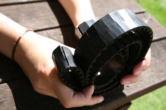

    Never break ? :) They break often and regular if not changed ! Even on smaller 3 - 4 Cylinder engines with just 2 Cams and less force on the belt. On a V6-V8 it happens quite faster. Look at a old belt how it looks then you will see easily why it will break sooner or later :) If tooth are already missing it is a ticking time bomb.
    Thats how it will look like if not changed regular dependend on time and milage ! ->
