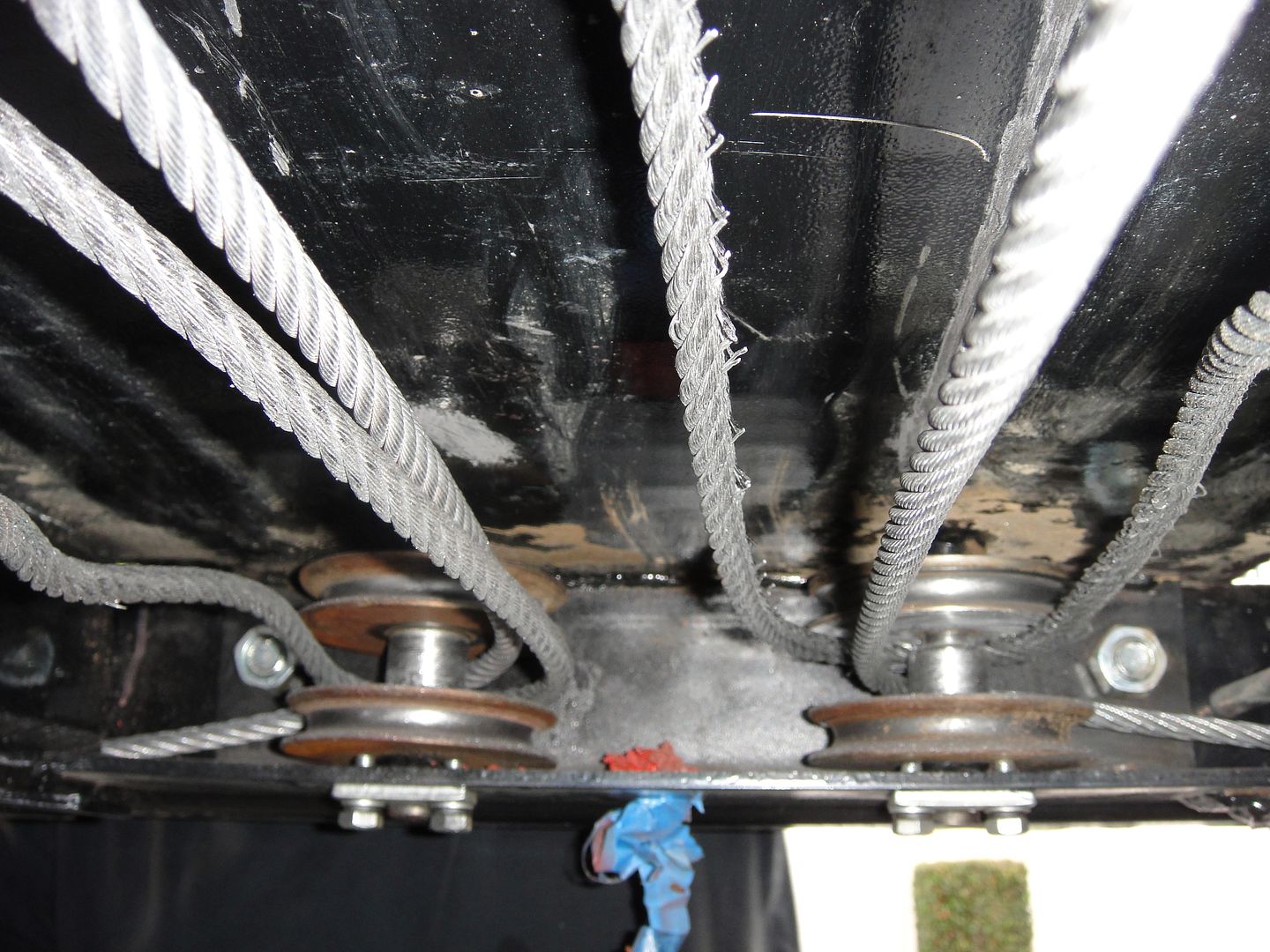

    Not sure exactly where to put this but I experienced my lift getting stuck yesterday with a car on it. Doing some investigating I discovered that the wire cables had fallen off of the pully system. I had to put it on the locks and disconnect all of them and restring them. What a Pain. Here are a couple of pics... Lift is 5 years old but it was kind of nerve racking.

    I can imagine that would be extremely nerve racking!! and dangerous! Any idea what caused the cables to jump the pulleys?

    I think I had jacked the lift up on one side and had a car leaning at a sevear angle to do maintainance and they slipped off slowly then a few months ago the lift started making these scratching a d scraping noises

    In one of those pics, looks like you have some cable damage. Might want to have the checked out.
