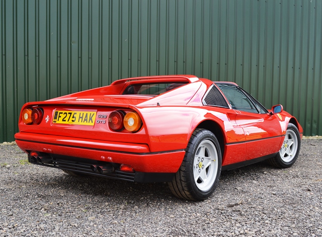

    Sorry Steve: I'm not sure for QVs, it should be checked, but it could well be stock, because these are "Euro" cars.
    Remember, and this I'm sure, that for 328s in Europe the "body colored" roof spoiler was available as an option (the ONLY option at no extra cost!) and many euro 328s have "body colored" roof spoilers (except the french cars: Ch.Pozzi didn't offer it).
    I have an original flyer from 1988 from "Auto Becker" in Germany listing the options available for the 328, and the "body colored" roof spoiler is on it. And 80515, my German 328 GTS, has a "body colored" roof spoiler; this is one of the reasons there are two different type of spoilers in the part catalogue: only the "smooth" one can be painted without being sanded before.
    So on an "euro" car, it could well be stock and ordered from the factory.
    Rgds

    Would never deny that individual F Dealers could offer many special treatments -- so something like that can be "original" to the initial Buyer, but the SPC difference for the rear spoilers is noted for the two body styles (GTB vs GTS) not the surface finish. We've had a lot of euro cars imported to the US, and I can't recall ever seeing that body-colored spoiler treatment (and it wouldn't be required by the US to change it ;)), nor recall seeing it in the photos posted here. Is it a common thing in Europe?

    On 328s, almost ALL cars have the body colored roof spoiler in the UK; in Germany and Italy, it is about fifty/fifty. But in France, it was not offered by Ch.Pozzi, the historic importer.
    You choosed it when ordering the car, it was at no extra cost, and the car came from the factory with it already painted; there are pictures of rows of new 328s outside the factory, some with black spoilers, other with body-colored one.
    Of course, it had to be the "smooth" one because you could'nt paint the "coarse", due to the material used.
    I must say that I am not sure for injected 308; I must ask Alberto about this.
    Rgds

    I've seen lots of QVs in UK with body coloured rear spoilers. But I can't vouch that they left the factory like that as it's just my observation when I am looking at the RHD cars in particular.

    On 328, it was a factory option. On QVs, perhaps also, but it must be cross-checked before stating anything for sure.

    The roof spoiler was an option, either body-coloured or black, on QVs. At extra cost, of course. Some, though, have changed colour over the years and I don't know if it is original on this car or not.

    Well, you should always be careful because we once asked the question on this forum for 328s, and although the "smooth" spoiler was normally intended for GTBs (in Black or painted) or painted on GTSs, it appears that a small number of GTBs did indeed receive the "coarse" one from the factory...
    But, on principle:
    "smooth" spoiler goes:
    - on GTBs were it could be black or body color (if that option was available)
    - on GTSs when the option for the spoiler to be "body color" was available.
    "coarse" spoiler goes on GTSs which have black spoilers, where its texture is matched with the one of the targa top.
    Black GTSs in Europe may however also have a "smooth" spoiler painted black. Mine does, but the car is metallic black.
    Rgds

    I saw dozens of euro QV here in Italy, in the eighties: here around Modena there were an incredible number of those cars (Italy was Ferrari first market at those times, with 30-50% of sales more or less...) . All of them had black rear spoiler.
    My 328 GTB was wingless too, but it was very uncommon
    ciao
