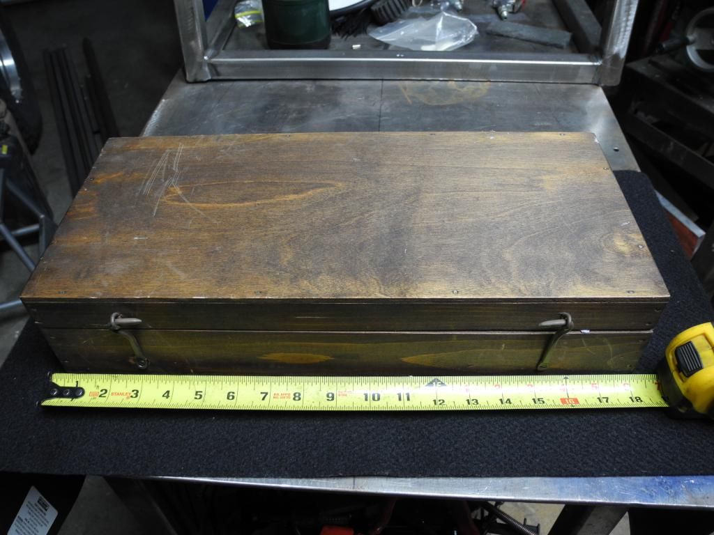

    I acquired a handful of Ferrari parts and pieces with a larger lot of automotive parts and pieces, included in said lot was this thing. I'm told it's a factory Ferrari hub tool, and that it's very valuable, but I have no idea what sort of hubs it's a tool for, if everything in the box is actually part of the set, if I'm missing anything, and what "very valuable" means.
    Anybody have a guess or better yet, know exactly what this tool is for? The gentleman I got it from has owned too many Ferraris or different vintages for me to even take a guess as to which one it could have been for.
    The outside of the box
    The stuff in the box
    For some reason the tweezers and the brass piece don't look like they belong in the box. Also the small wrenches appear to be spoke wrenches perhaps?
    That "T" shaped piece with the round collar or it appears to be the same thread (though I haven't thrown a thread mic. at it) as the knock-off lugs I got in another crate, leading me to belive it is definitely a wheel service kit of some sort.
    The only piece with any identifying marks at all
    The box is slightly broken, those two "L" shaped bits of wood are cracked off, but could easily be glued back on
    Really is a pretty cool service kit, just have no idea what it's for

    Looks like an early Ferrari (212 Inter/Export) toolbox, if this is real and complete pretty valuable...
    ciao
    Oscar
    ps I looked for one some time ago but impossible to find.

    Bringing this back up to the top, The tool kit was sold/shipped, and the buyer has questioned it's originality/authenticity. It's being returned to me, and money refunded, last thing I want to do is pass off a fake, if indeed it is a fake.
    Could anybody help me identify weather or not it's a a real factory kit, or reproduction?
    The welds on the tools appear to be very sloppy tig welds, except for one piece which appeared to be oxy-ace welded. The fact that they were partially tig. welded caused the buyer a concern, but it's a process I know existed in the 1950s, and I'd have assumed anybody with the skills to reproduce these, would have welded then more cleanly than this.
    The finish on the box itself was also a concern, but the finish of the wood (rough sawn vs smooth finish) again points me to the conclusion that it's older than it is new.
    Hoping somebody can shed some loght on how to spot a reproduction vs. an original.

    It appears to me from the pictures to be a reproduction box and tool set. The finish on the tools, especially the hub puller is not like the originals, the valve compressor tool looks too cleanly made, the box does not have a 50 year patina like original boxes I have seen; it just has the black finishes rubbing off the tools onto the wood. Looks just like reproduction mechanics box that was available in small quantities some years back.

    What were the tools originally finished in? Most of the tools in this kit appear to be blued, or tool-black. The hub puller looks like it could be black oxide. The different coatings were also part of the reason I thought it was original.
    Assuming it is a reproduction, any idea who was making the reproductions, or where I mite find more info on them?
    Care to hazard a guess as to what a "ton of money" may mean? Trying to establish a fair asking price, based on the response I got in the initial for sale ad, I was significantly under the market. Need to find this kit a new home.

    Yes, originals were black oxide, but the finish on the puller gives it away, a satin, non-oiled finish, looks like a black phosphate finish as compared to black oxide, I doubt it is an original puller. These repro machanic's kits were around $4,000 when made if I recall, some years ago. No idea what one would pay for this now, but nowhere near as valuable as an original.
