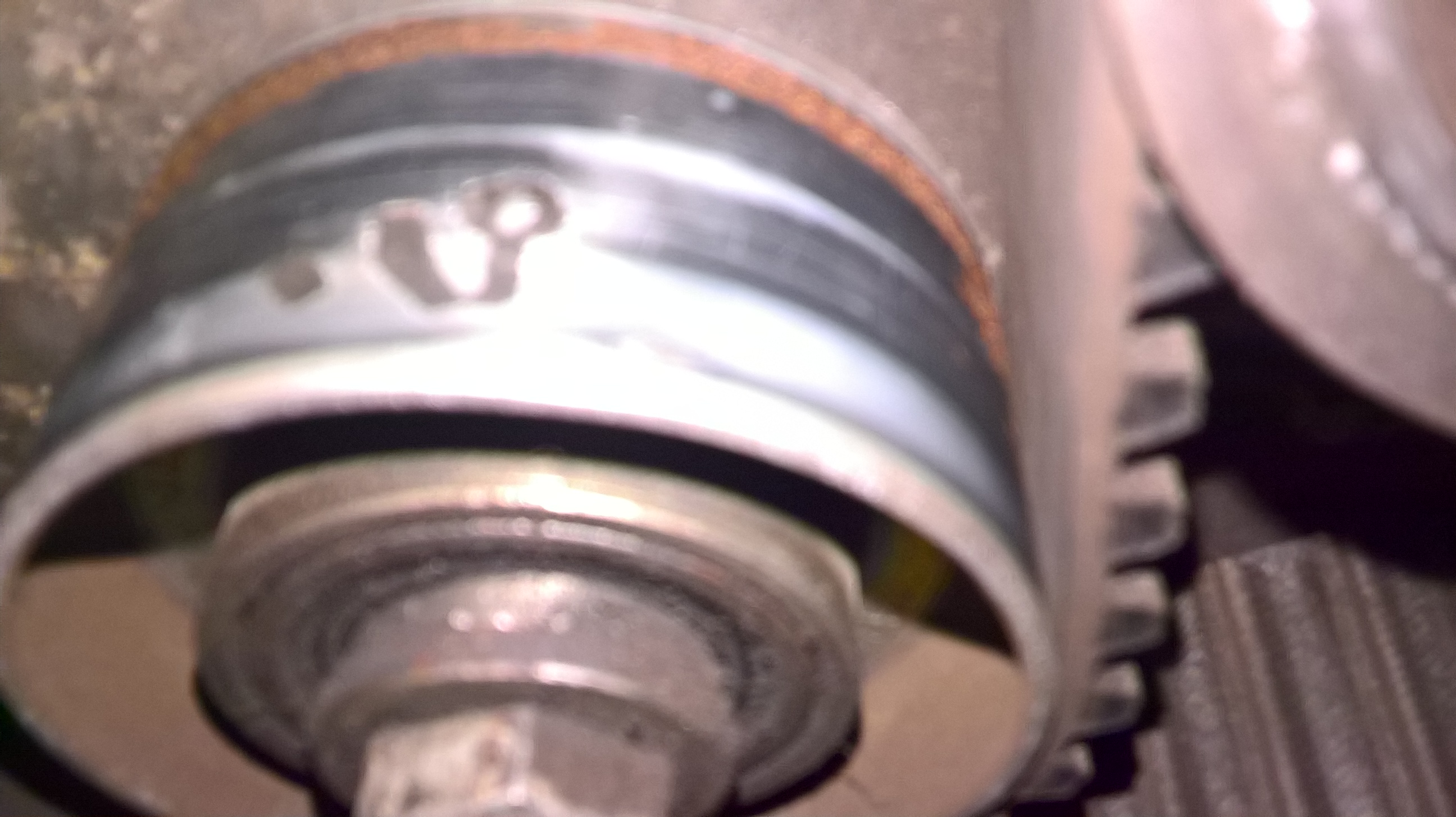

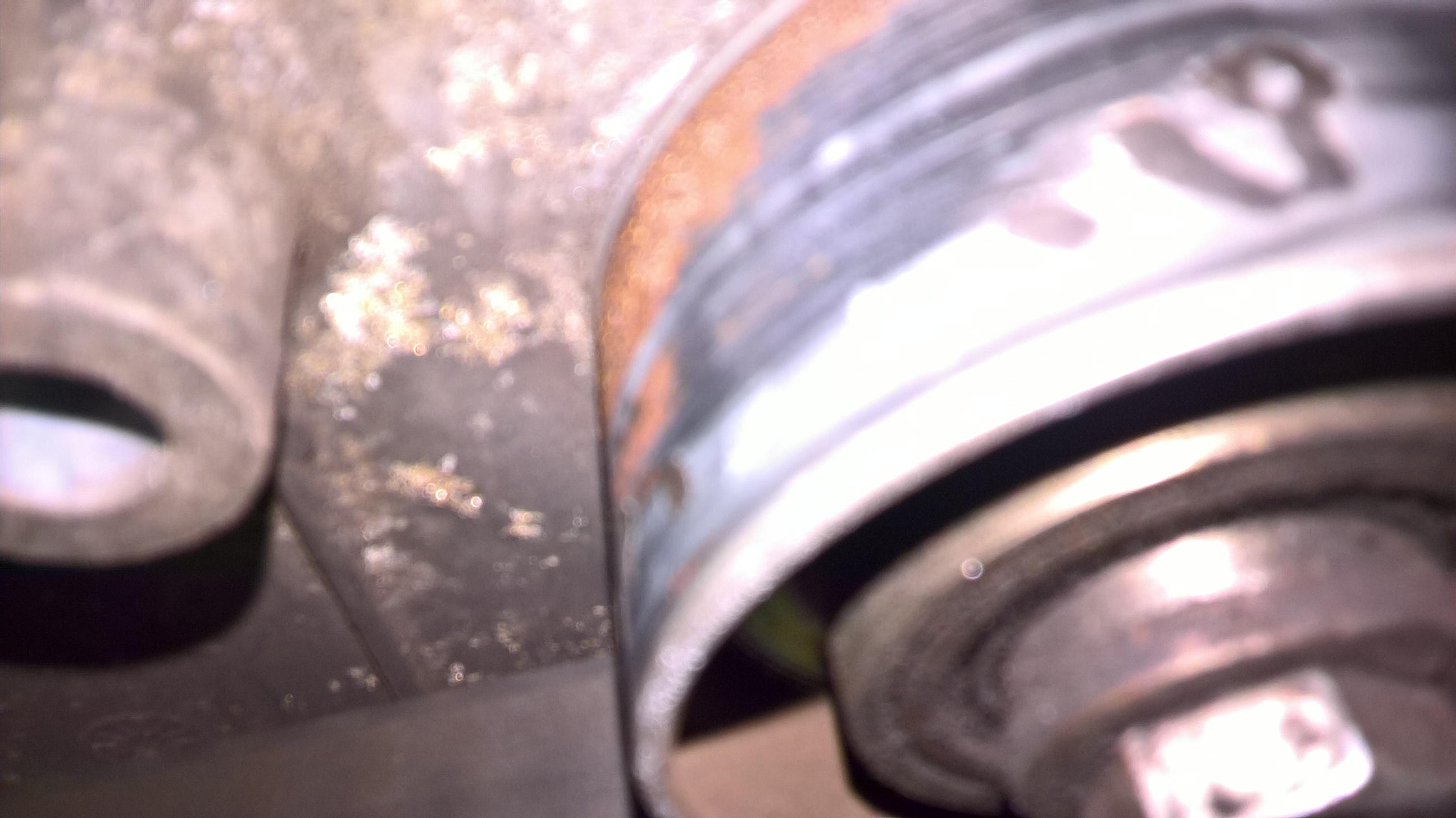

    I have undone the timing belt cover but not able to remove it due to the radiator hoses. Don't want to bother with this and enough to have a first look.
    Checked the pulley fences look OK. Hard to see the water pump and hard to say if there is play in the pulley or the tensioners.
    The passenger side tensioner is a Hill but the other one is a standard and in what a health.. (unable to have a better quality)
    The rubber marks on it make me think it has seen a old belt and the rust tells also..
    As I was fearing, the previous mechanic did screwed everything he touched on this car and since he also did the timing belt... However he did steal the previous owner since the tensioners are written on the bill and it looks clear that at least this one hasn't been replaced 4 years/4000km ago...
    Don't know if it is the one making the noise but he has seen better days..

    Base on those pictures, that old idler bearing is finished, especially with the rubber skid marks from the belt on it.
    Time to drop the engine and do a full major service.

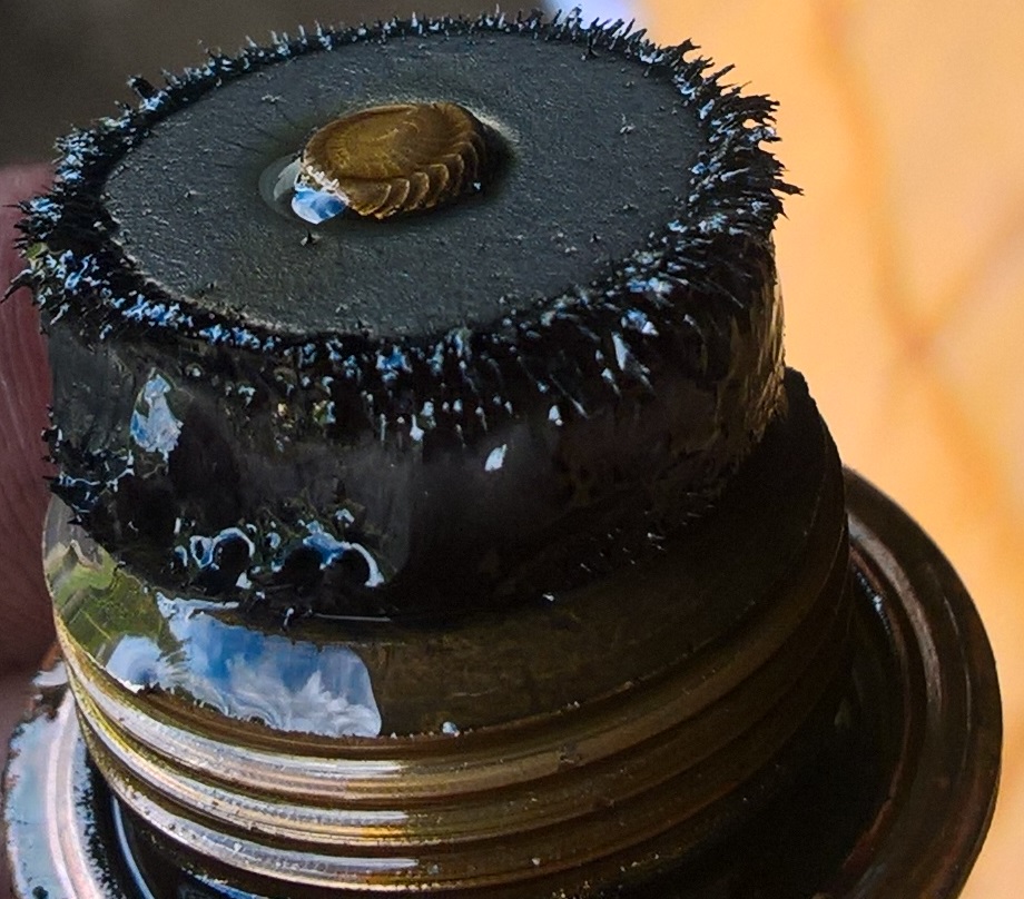

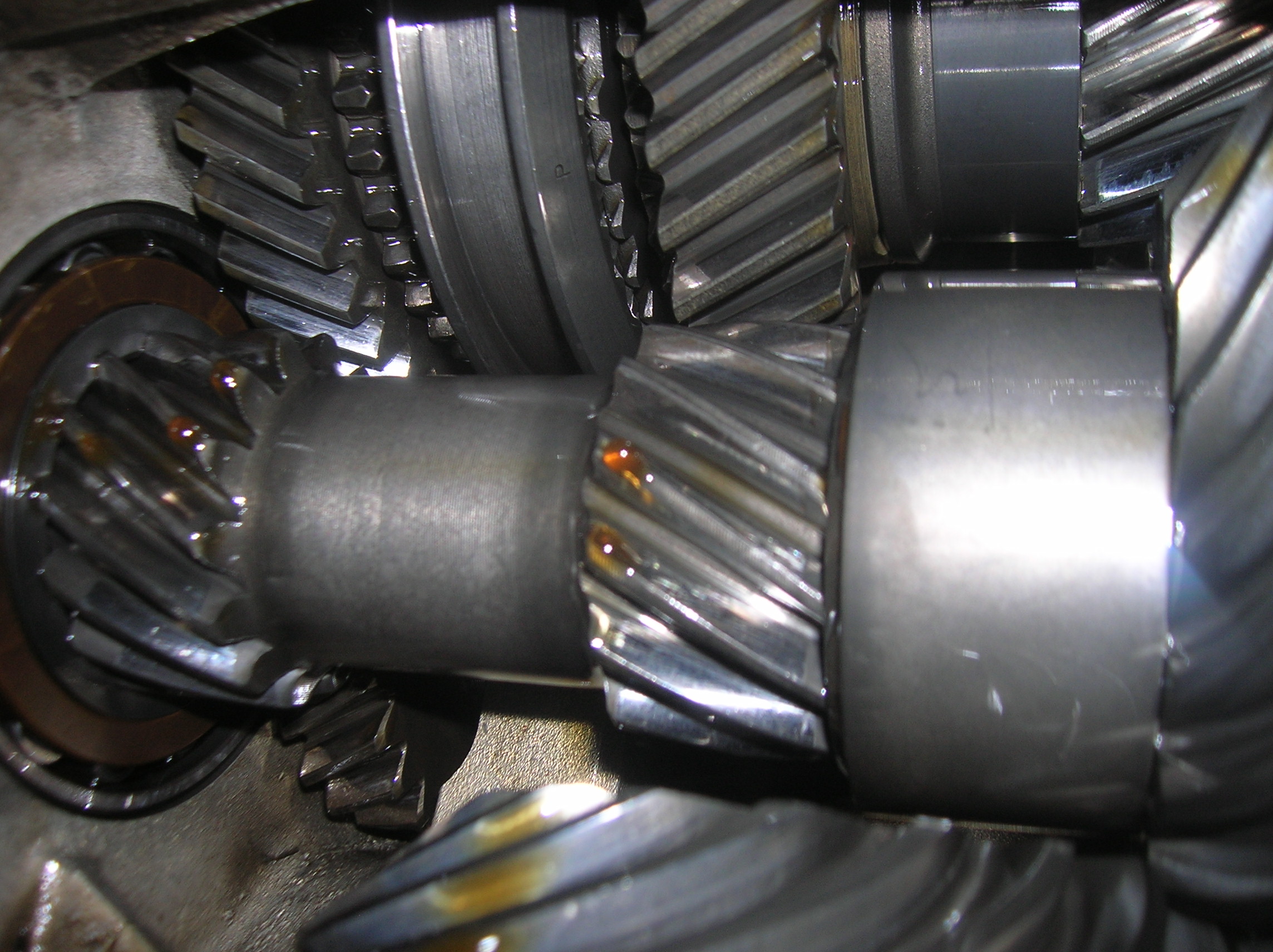

    I am just back worrying regarding the gearbox. Since checking the car before buying it, I am hearing a small noise coming from the gear stick. It looks to be directly linked to engine speed but I am still not sure it there is a link to the car speed also. Have the feeling it is increasing from 55mph but should check in lower gears.
    It can be heard in the background in this audio (sorry for the poor quality).
    http://rupp3r.free.fr/mondial/gearboxnoise.mp3
    I am doing some declutch while driving and we can hear the noise coming down (but I still have to tune the engine since it is sometimes keeping some revs at "idle").
    I have drained the gearbox and had a look at the inspection panel. There is not a lot of filing on the drain plug but I think it has been changed 4000miles ago. I haven't found any bits of metal anywhere.
    http://rupp3r.free.fr/mondial/gearboxoilplug.jpg
    Here is a picture from the inspection panel, I can't see anything strange.
    http://rupp3r.free.fr/mondial/gearbox_ip1.JPG
    I am quite psychotic regarding the input shaft bearing/nuts issue on the 3.4 gearbox and I don't know if the noise I am hearing is "normal" or not..?
    Thanks
