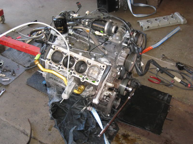

    As alot of you guys know i just finished my Kevlar clutch on my 360 . Ive driving about 1500 miles on the car since I did the clutch and changed the oil. I have always used royal purple oil in my Ferraris . I chose to use mobil 1 o-w40 this time due to reading about the benefits of it . Well iam here to tell you guys to really think twice about using it . Iam having to rebuild my entire engine due to connecting rod bearing failure on the 1 and 8 cylinder rods . what was left of the bearings was found in the oil pickup . The connecting rods slapped the crank so bad that they damaged the valves in both cylinders . The timing was spot on and the belts intact . I will send the oil out for testing but at this poit its prtty clear what caused the damage . you can see visiabe blue heat marks on the connecting rods . Iam thinking that the o weight oils is two thing for these engines thus starving the bearings of oil .
    Ill post picks when I can .

    You dont mess with the timing when you do the clutch . Both the guys working on the engine have over 20 years experience each and have never seen this before . They are both factory trained . I was just trying to help avoid other peopel having this same problem . The only variable that was changed was the oil . I can see how this is going to go over so I wont even bother to post pictures .

    Here are the pics .[​IMG]
