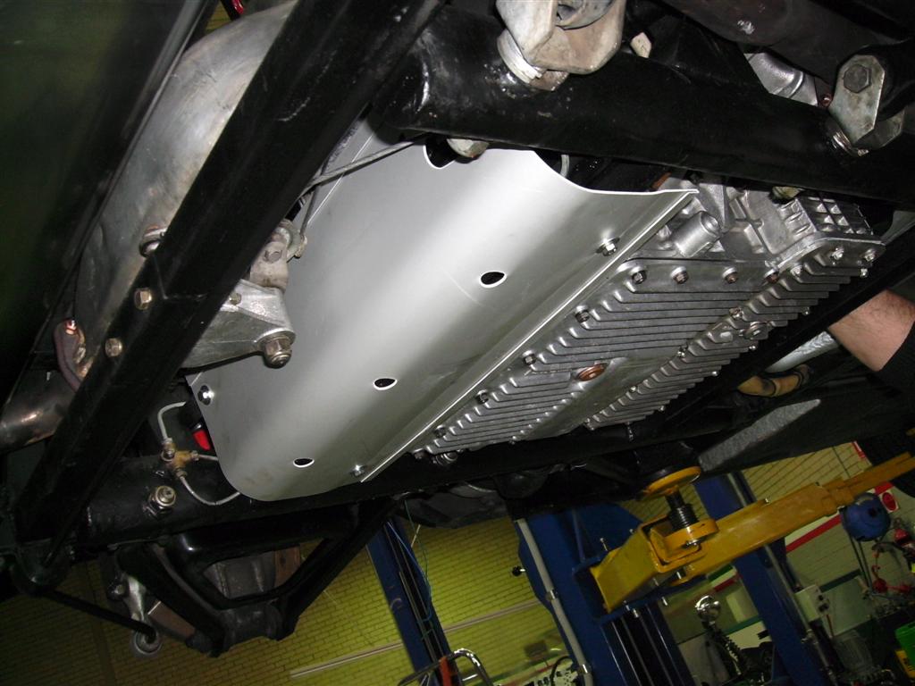

    Now that the oil pressure in tight right turns is resolved I am looking into installing a skid plate. Murray from down under has these available. I am interested in your impressions.
    This is what he had to say about it,
    "Attached are some things I make for the 308 that may be of interest to you and some of your buddies. The pics Skid plate 11 and 12 are just that a skid plate for the normal front valance for 308's. As you can see it is custom made and shaped to protect the underside of the car where the fibreglass valance meets the steel chassis. This area is commonly neglected, and if left usually comes lose and flaps or vibrates. It is made from 6mm (1/4") alloy plate and has been slotted to allow for wheel alignments without having to be removed. The mounting screws are counter sunk to avoid any collision. It works, and has saved the underside of my own car many times, irrespective of how careful I have been. The Photo 3785 is a vented front panel that replaces the standard blanked panel just to the rear of the skid plate. This allows more air to be drawn from the back of the radiator and out under the car, when it's under way. It is made from 2mm thick alloy and is powder coated in black and has the larger hole for the air-con drain.
    The alloy scoop pic is the scoop that goes at the rear of the engine and travels up to cover parts of the handbrake cables. It is as per the original. You will see it in the parts manual".
    I am considering ordering them from Murray. This is what he said about costs,
    "If any of these things are of interest to you or some of your other 308 owners let me know, and I'll see if I can do better on the costs.
    Skid plates $120.00 US, Vented panel- $65.00 US, Scoop- $30.00 US.
    We would have to add shipping, possible import tax, and US shipping. From my previous experience this wouldn't add much to the over all cost. If anyone is interested in a group buy let me know.

    These skid plates are for the front lower part of the car. I thought they were for the rear first until I read his description.
    ""As you can see it is custom made and shaped to protect the underside of the car where the fibreglass valance meets the steel chassis. This area is commonly neglected, and if left usually comes lose and flaps or vibrates. It is made from 6mm (1/4") alloy plate and has been slotted to allow for wheel alignments without having to be removed. The mounting screws are counter sunk to avoid any collision. It works, and has saved the underside of my own car many times, irrespective of how careful I have been. The Photo 3785 is a vented front panel that replaces the standard blanked panel just to the rear of the skid plate. This allows more air to be drawn from the back of the radiator and out under the car, when it's under way. It is made from 2mm thick alloy and is powder coated in black and has the larger hole for the air-con drain.""
    Dan

    Murray also makes a multiple-piece skid lip for 308 Euro valances. I thankfully have it on mine-requires drilling very small holes in the valance lip. It protects the forward lip from scraping--very valuable.
    I also have the vented lower panel and oil sump baffle--great ideas.

    My porblem is not so much the front cross member as the front corners of the chasis - going into driveways is a killer. If he has somethig for this i am ready to put the $ down. I am tired of grinding off the front corners.

    It looks like that skid plate should cover your corners.

    i recently fitted that scoop. i was amazed at how nicely it just "finished off" the look from the rear.

    That curved panel is an OEM piece and actually directs the air UP, I believe....when I drive, leaves blow up out of the engine cover, at speed, the rear roof spoiler also helps to break up the natural dead air behind the rear glass.
    That is a nice protection plate.
    I armored up the front with three seperate pieces as I don' want to run over somehing big if it gets knocked off.

    Does Murray make anything for the front of a usa car. The lower front corners about 8 inches back from the spoiler lip take a hell of a beating. The skid plate that fits just infront of the suspension mounts looks stout and well made but i am looking for a bit more protection for the front just behind the spoiler.

    It's tight to the metal cast ribs of the tranny, or just below....I don't think it does.
    It's definately on all my early 308GTBs....I beat one up pretty badly, in the truck runoff of Yosimeti Park.

    I'm gonna need to get under the car to see. I installed my Tubi, adjust the handbrake cable, change fluids, etc, so I've been under there lots of times, I just can't seem to figure this part. As I recall, my muffler cover connects to a sheet metal pan that connects to the gear box.
