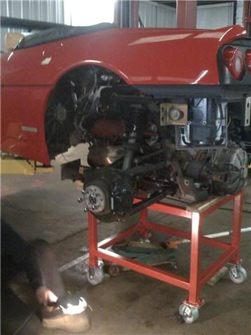

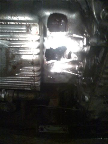

    Have you taken it apart yet? I am really curious what happened, if it was a rod failure or a bearing which caused the rod to fail. If it was a rod failure, specifically what kind of failure.

    We are just getting it out now , from what I can see through the two holes in the oil pan and from the mangled rod cap , looks like a rod bolt snapped off . it is on the number 6 cylinder . There was enough force to bent the rod over the crank and take out the oil squirter . Ill post pics soon .

    Sadly my previous 355 went the same way (failed rod bolt)

    QV rebuilt it, IIRC it needed a new crank (cracked), sump, oil pump, 2 rods, 2 pistons, 10 valves and about 80 Hours labour I think! they did manage to repair the block though as it was only a 1" fillet along the bottom edge that was broken away, whoever welded it did a fantastic job and it was invisible from the outside
    THe pics of the Sump are exactly as Mike from QV took it off the car ie full of conrods, gudgeon pins etc
